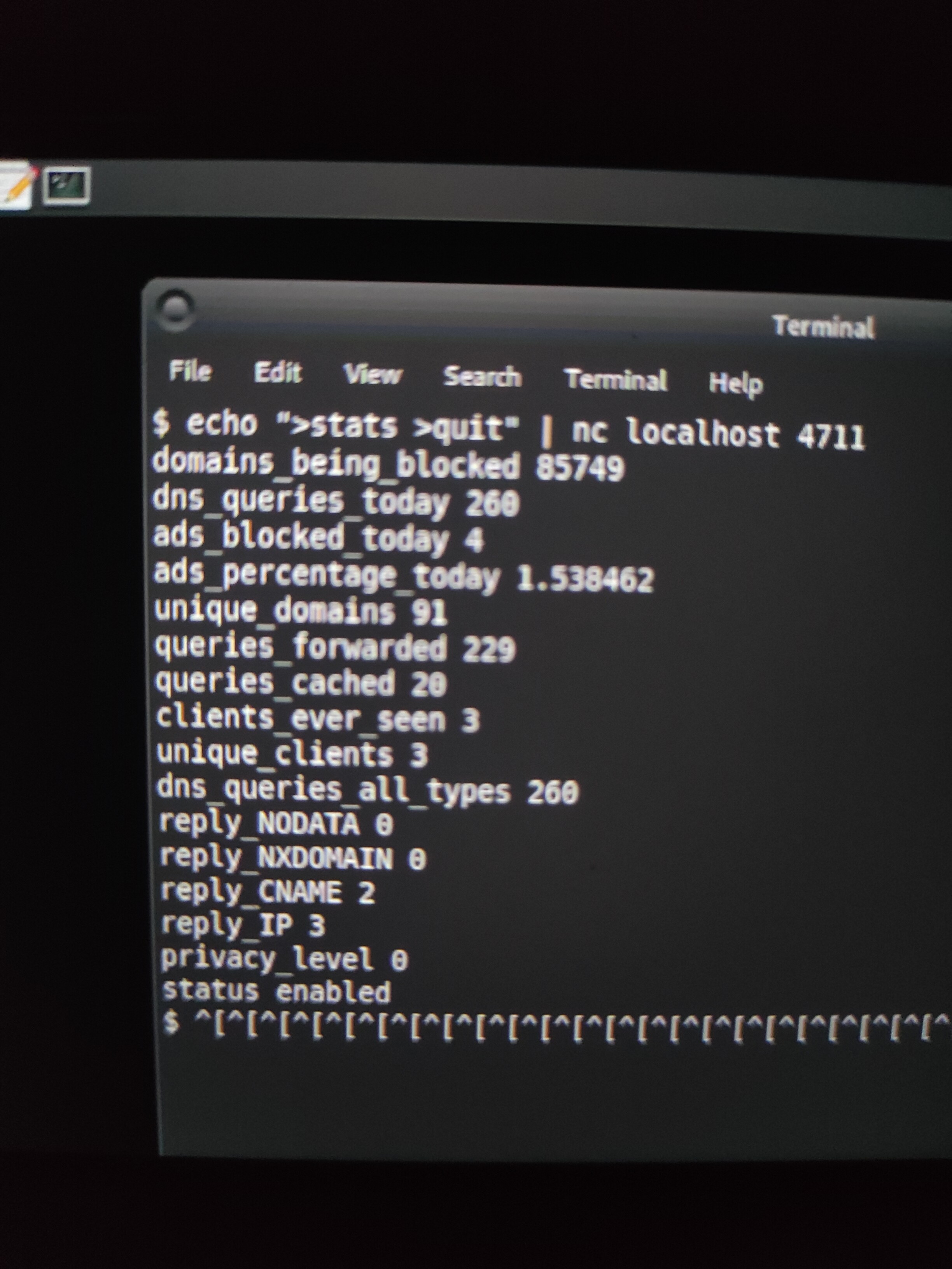

Let's take a look at the activity for the past 24 hours. What is the output of the following from the Pi terminal:
Sorry for the picture for showing the data but Im on a different device and it was the easiest way of doing it
Apparently everything works, but the frontend web panel can't load stats and it's red circle on "ftl offline" . Load circle is green. Memory usage is green. Active is green .
The machine is fresh since I'm dedicating it for pihole. Could it be a permission problems ? Maybe that's why the frontend can't show FLT data ?
