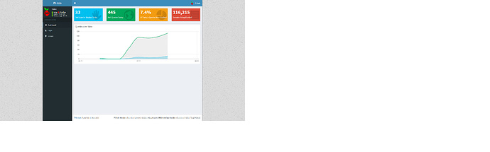

Hey guys would be great if we get some basic Information about FTL how to activate... What it does exactly...
BTW do to the FTL option on the Web interface the option to see the temperature is gone
thanks for any help

What steps did you do to get to this screenshot you showed?
i just went on my web interface and logged in took a screen

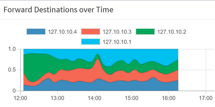

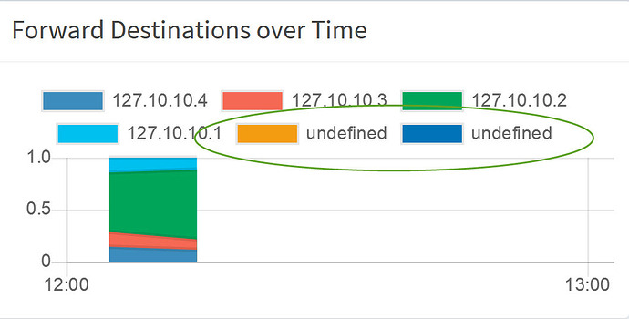

dashboard results (2 undefined resolvers)
Hmm, please tell me what
http://pi.hole/admin/api.php?overTimeDataForwards&getForwardDestinationNames
says.
{"over_time":{"1489575900":[1,1,4,1,0,0],"1489576500":[1,1,6,1,0,0],"1489577100":[1,1,6,1,0,0],"1489578300":[11,5,16,5,0,0],"1489578900":[13,13,28,13,0,0],"1489579500":[4,4,4,4,0,0],"1489580100":[5,5,6,5,0,0],"1489580700":[28,43,28,43,0,0],"1489581300":[9,12,9,9,0,0],"1489582500":[52,89,43,81,0,0],"1489583100":[37,62,15,16,0,0],"1489583700":[29,27,16,43,0,0],"1489584300":[14,14,14,14,0,0]}}

I reinstalled everything again, after the problem was gone. This time I got FTL 1.5.1 from the start, no upgrade required. Initially the graph showed 6 resolvers, witch seamed normal, because you have to select some resolvers during installation. I chose OpenDNS and the resolvers were even listed by name.
I then removed the resolvers from /etc/dnsmasq.d/01-pihole.conf and /etc/pihole/setupVars.conf. The graph still showed 6 resolvers, but the name of the OpenDNS servers changed into undefined.
I ran pi-hole -f, no change, but after a reboot the undefined resolvers were gone.
