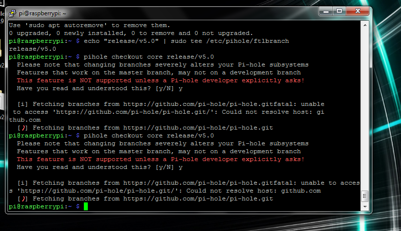

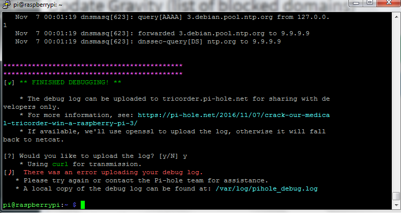

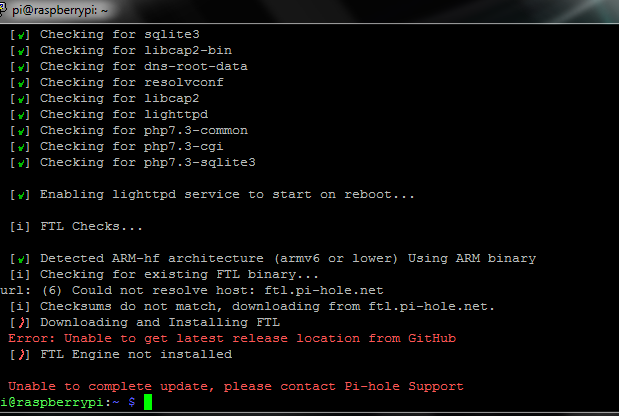

Problem with Beta 5.0:
[Hello, I'm receiving a ftl error, and it's not able to connect to obtain the latest release.]
Looks like it can't connect (or can't find) github. Does a ping github.com work?
Do you have unbound ?
Stop unbound else change ip at i think resolvconf.conf where that 127.0.0.1 locate is.
Then retry
No, not on the pihole. It returns a "Temporary failure in name resolution".
That is with "ping github.com", "ping www.github.com", or I even tried ping -c 3 -i 5 www.github.com". Actually even attempting to ping google. Maybe I need to reinstall the OS? And then the pihole? Start from scratch?

Chances are your device is configured to only use itself for DNS lookups, which is quite common with pihole setups, and now pihole isn't running then resolution is failing.
If you can ping 8.8.8.8 as Dan suggests then just add another nameserver line to /etc/resolv.conf (note - this temp change should get you back up and running for you to get pihole installed)
sudo nano /etc/resolv.conf
nameserver 8.8.8.8
once you add this line and save the file, DNS resolution should work again when it realises your localhost name server is down.
