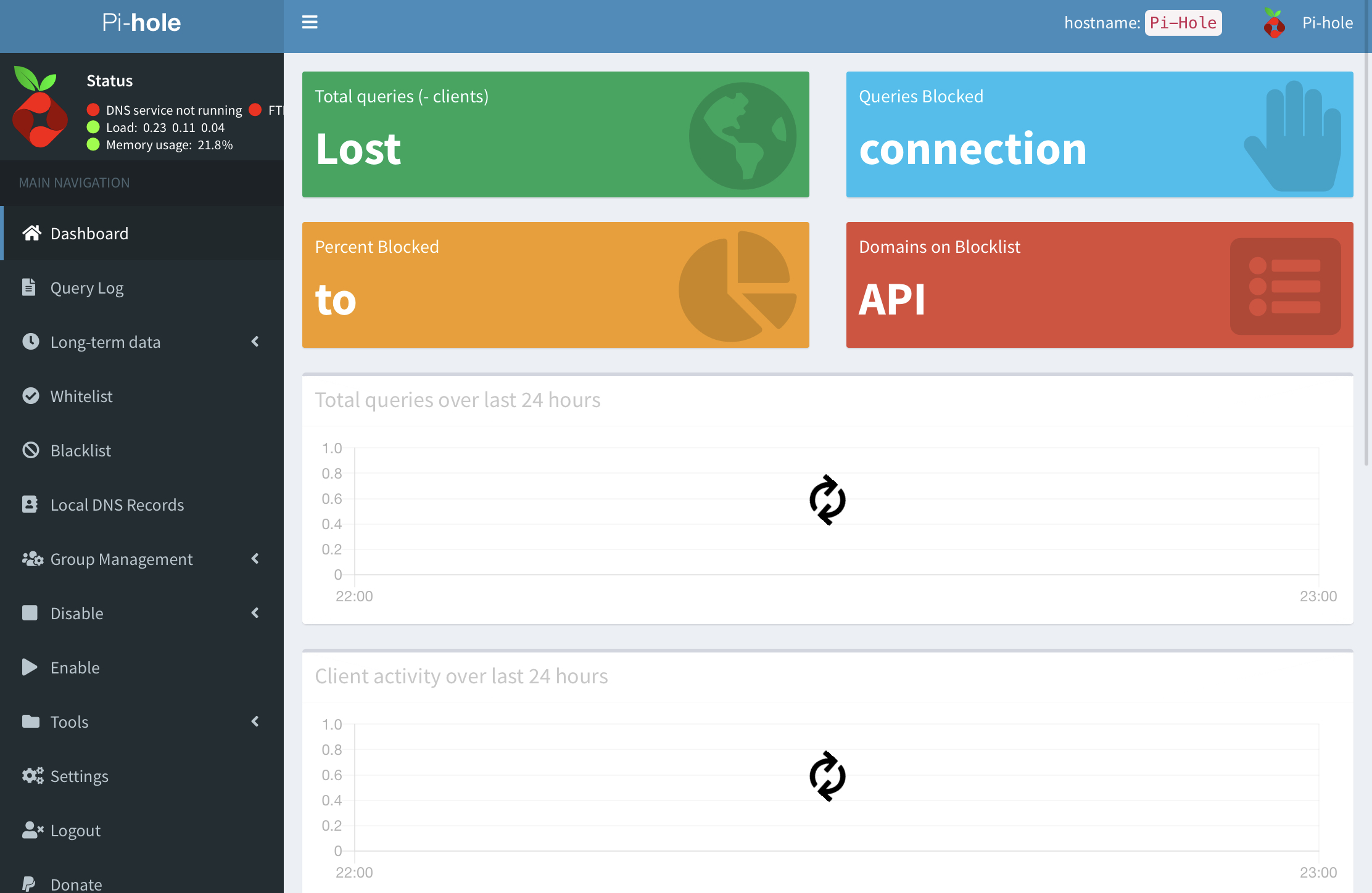

Ui looks like this:

The web ui still says FTL offline and dns service not running
