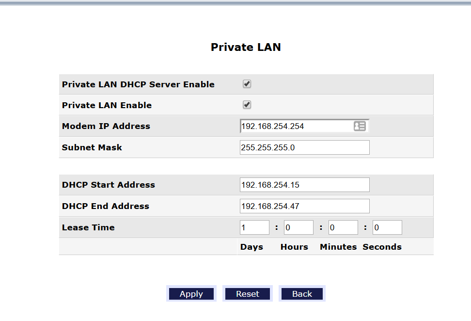

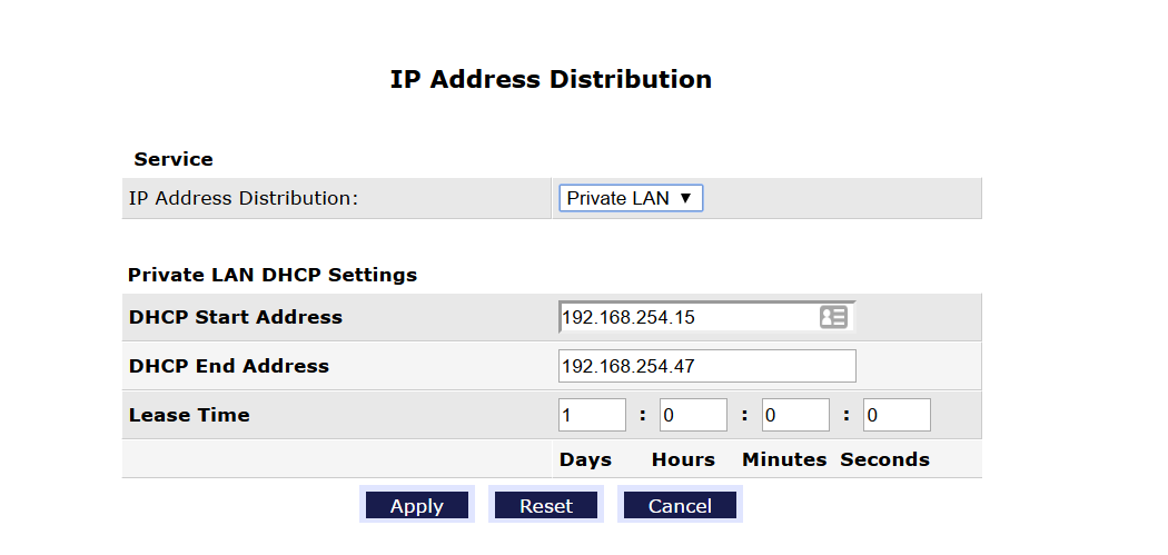

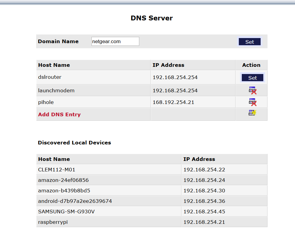

I cannot seem to get Pi-Hole to work right. When I add the pi-hole IP to the DNS it works on the Raspberry Pi that it is on but no other device. It seems like I have tried everything but obviously not or it would work. Below are the three main configuration pages from my router. What am I missing?
You appear to have a typo on the IP address of your Pi-Hole on your DNS page.
You might not have a place to set custom DNS servers. If so, turn off DHCP on the router and turn on Pi-hole's DHCP in its settings.
