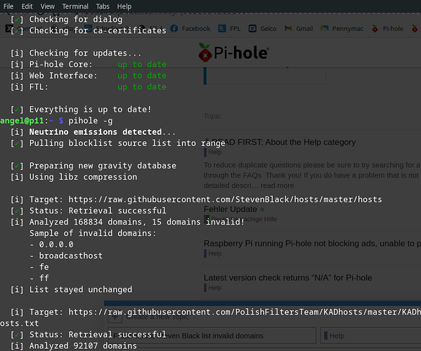

Fresh install, Steven Black list invalid domains
Fresh install of Pi-hole on Raspian OS 64-bit today, 1-16-23
The Steven Black List is reporting 15 invalid domains
https://tricorder.pi-hole.net/aewRWz4G/
This is normal. We updated the method we use to check for invalid domains, and those are identified. As described in the release notes:
https://github.com/pi-hole/pi-hole/pull/5009
jfb is correct. Those lines are incorrect and not valid domains. Please report those to the list maintainer.
As I said in the linked PR
Because we enter parseList with a less filtered source the number of invalid lines reported by gravity will increase.

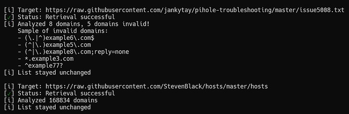

If I imported an adlist and didn't know why hostnames would be ignored I would see "ignored lines" or "unused lines" the same way, and be wondering what I did wrong and what I need to do to fix it, and would then post somewhere to ask. The exclamation mark also makes it seem dramatic, as if action should be taken.
[i] List contains 8 entries comprising 3 usable domains and 5 non-domain entries.
    Sample of non-domain entries:
I think the exclamation mark will be gone for cases like this.
This is not an error. The code is ignoring some lines because they are not used be pi-hole. No action is needed in this case.
Hello, I was just heading here to enquire about this issue after the latest Pi-Hole update as I had Steven's list pop up with an invalid entry report when updating gravity via ssh after noticing the exclamation marks next to the lists on the web interface.
It's good of Steven to chase this down and confirm that his lists are not the issue here, props.
On the plus side the gravity update did report an actual invalid entry from the blackbook list I use which I have reported to that lists maintainer.
I found the output from pihole -g quite alarming as it is not clear as to whether Pi-Hole is still blocking the remaining domains on the list or whether it didn't load the list at all after detecting "invalid" entries.
I'd like to suggest adding a simple console line edit to confirm that the valid entries on the list have been imported - purely for the sake of clarity for end-users so they know what Pi-Hole is doing with the lists when a rejection occurs, for example:
[i] Analyzed & Imported 168834 domains, 15 domains rejected.
It is. We only report the exceptions. You will see the total domain count for each list in the status column of the adlists page.
Yep I saw that in the web gui, my comment was regarding the console output when running pihole -g via the console:
  [i] Analyzed 168834 domains, 15 domains invalid!
      Sample of invalid domains:
      - 0.0.0.0
      - broadcasthost
      - fe
      - ff
  [i] List stayed unchanged
It does state "List stayed unchanged", but I guess the use of "invalid" here sent some alarm bells ringing for myself and plenty of other people, hence my suggestion about changing the wording used for this feature in the console output.

If you were looking for something more descriptive to insert for the sample of unusable entries, perhaps inserting a small bracketed section with examples before the colon to avoid adding extra lines, for example:
[i] Target: https://raw.githubusercontent.com/jankytay/pihole-troubleshooting/master/issue5008.txt
  [i] Imported 3 domains, 5 entries unusable by Pi-hole
      Sample of unusable entries [regex, wildcards, data after TLD, etc]:
      - (\.|^)example6\.com$
      - (^|\.)example5\.com
      - (^|\.)example8\.com;reply=none
      - *.example3.com
      - ^example77?
It's a little concise but in general I think people would get the gist of why those entries may be unusable without adding a wall of text into the console.
