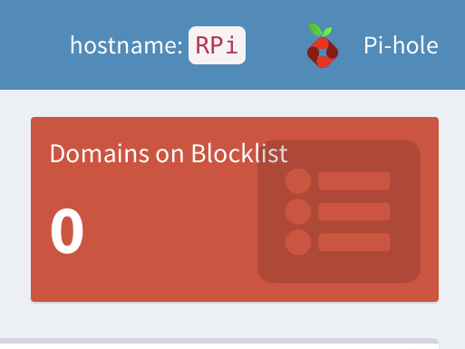

Dashboard shows 0 domains though they are downloaded during the process
