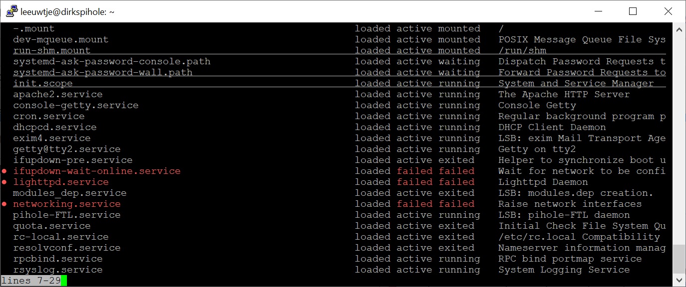

After installing pihole with the pihole install script, the networking, lighttpd and other related networking services in the red lines stopped working. I tried to check out forums, but I am out of idea's
This is a VPS machine. Before running the pihole script all the red lined services in the picture were running ok. I chose comodo DNS during setup .

I did the install procedure again, starting from fresh installed debian 10 system, a situation where all services are working, (no red lines). I installed pihole. (curl -sSL https://install.pi-hole.net | bash) Just after the fresh pihole installation I did another: pihole -d
Same situation as in the picture.

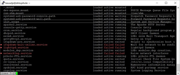

The reconfiguration finished, but the same errors appeared again afterwards, as in the first image of the previous attempt. After rebooting the server the same red lines came up in services for the same services. So, After reconfiguration there was the same situation, which is logical, nothing was changed before pihole installation.
networking.service: Failed to start Raise network interfaces.

Couple things I see from your original post:
  1. Looks like you are running static IP, so why is dhcpcd.service running? Might help to see the contents of your /etc/network/interfaces file.
  2. apache2.service is running. That will likely be an issue for lighttpd.
I'd try stopping those two services....
systemctl stop apache2 dhcpcd
You've configured your Pi-hole for a public IP address
[ DIAGNOSING ]:[Networking IPv4 address(es) bound to the venet0 interface:
194.xxx.xxx.139/24 matches the IP found in /etc/pihole/setupVars.conf
Note that exposing Pi-hole's host via a public IP address may turn your Pi-hole into an open resolver, which poses a potential threat for all Internet users, e.g. by serving as a multiplier in a DNS Amplification attack.
The Pi-hole team strongly discourages Pi-hole’s usage as an open resolver, and we won't provide support in that case.
That said, I'd somehow guess your venet0 and venet0:0 to be tunnel interfaces for VPN connections.
Are you perhaps already trying to make your VPS Pi-hole accessible via VPN only?
In that case, you should configure Pi-hole for the private IP address bound to your VPN tunnel interface (which should have no public IP at all). You may also refer to our guides for further suggestions, e.g. for OpenVPN or Wireguard.
Guys, in the last 2 days I needed my time elsewhere, so this is a later reply.
Thanks you both for the arguments. Rutrow, by simply stopping and uninstalling the 2 services like you suggested. I solved the problem! Just reboot the thing and all red lines disappeared in the systemctl service list. Pihole started running perfectly.
