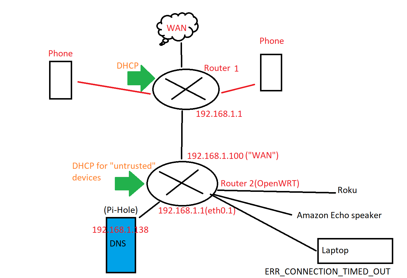

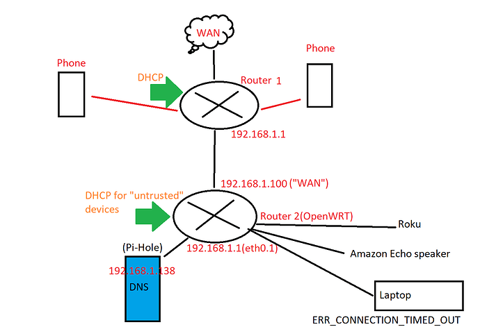

Someoe* (or rather something**) seems to be rate-limiting your Internet connection.
This explains why you have more issues with unbound as it has to do many more requests when walking the entire DNS path compared to a single request you send out to some external recursive DNS resolving service such as Google's DNS.
*) Maybe your Internet service provider (ISP)?
**) Maybe even your router?
probably my router since I doubt my ISP throttle my network. thanks for your help. Could be my router 2 having issues since if i were to directly connect to router 1, there is no problems at all.(Yes I took CCNA in 2016 but I didn't went for certification :stuck_out_tongue: )
Why is your Pi-Hole on the router for untrusted devices? Have you tried connecting it to Router 1? With your routers in this configuration, are you double-NAT'd?
