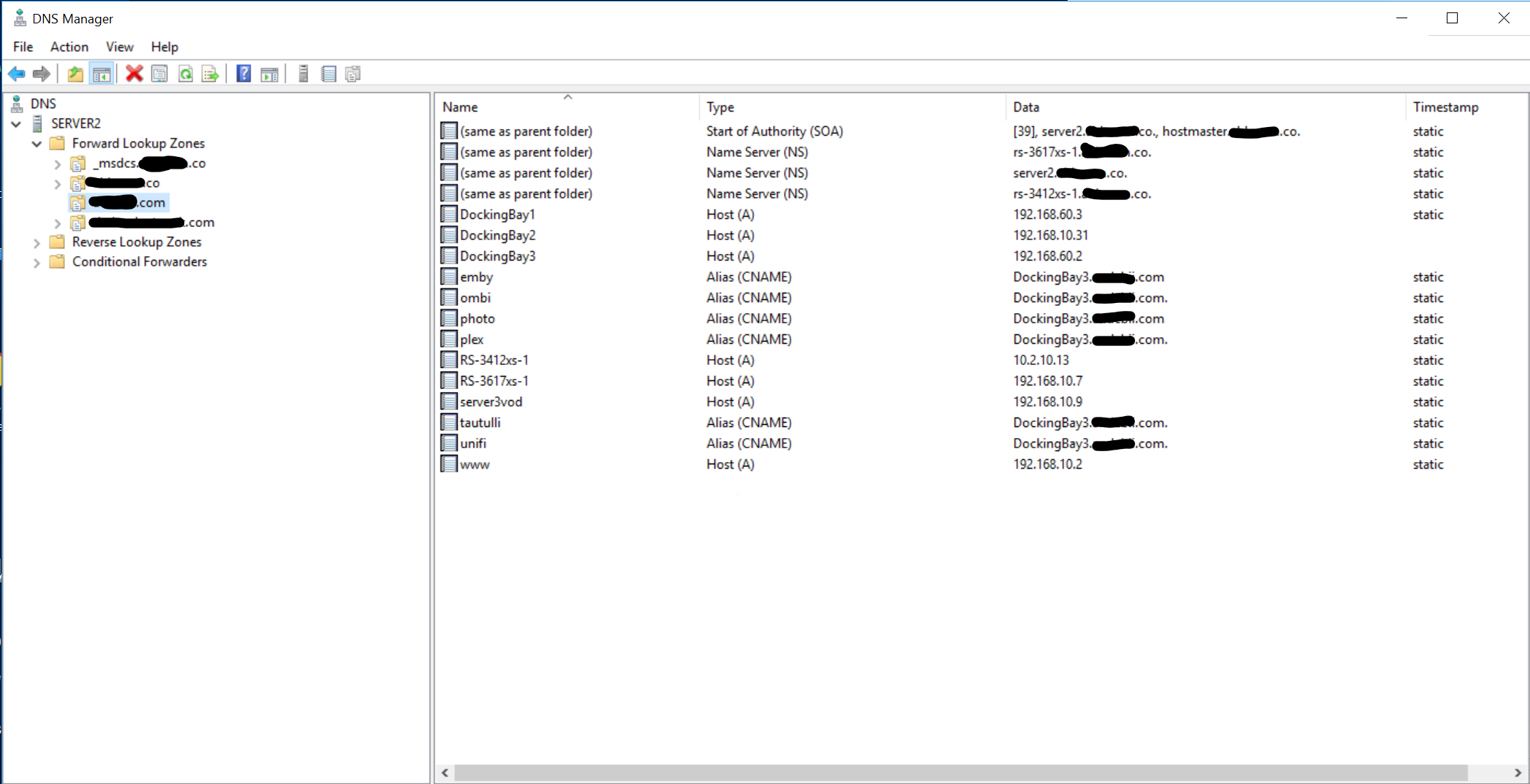

I have a windows server with multiple forward lookup zones (example1.com, example2.com) setup. My DNS lookups go client -> Pi-hole -> Windows Server.
Pi-hole should return internal IPs for all of the domains setup in my windows server.
Pi-hole is not returning local IPs for one of the forward zones, for this zone it's returning my public ip. From my client PCs if I do an nslookup for emby.example1.com I get my internal IP, but if i do emby.example2.com I'm getting my external IP. I don't think it's an issue with my server because an nslookup of emby.example2.com on the server returns the internal IP. Any idea when for the second lookup zone it's returning my public IP?
Screen Shots of my setup:
Windows DNS settings:

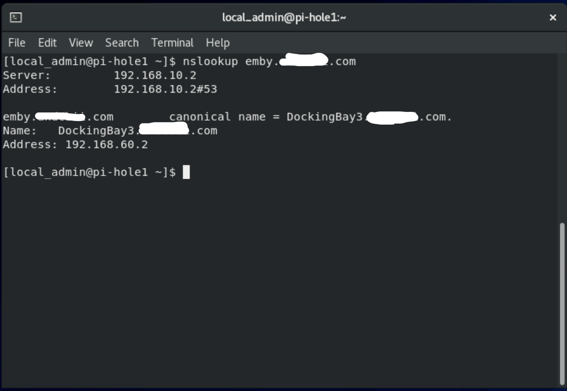

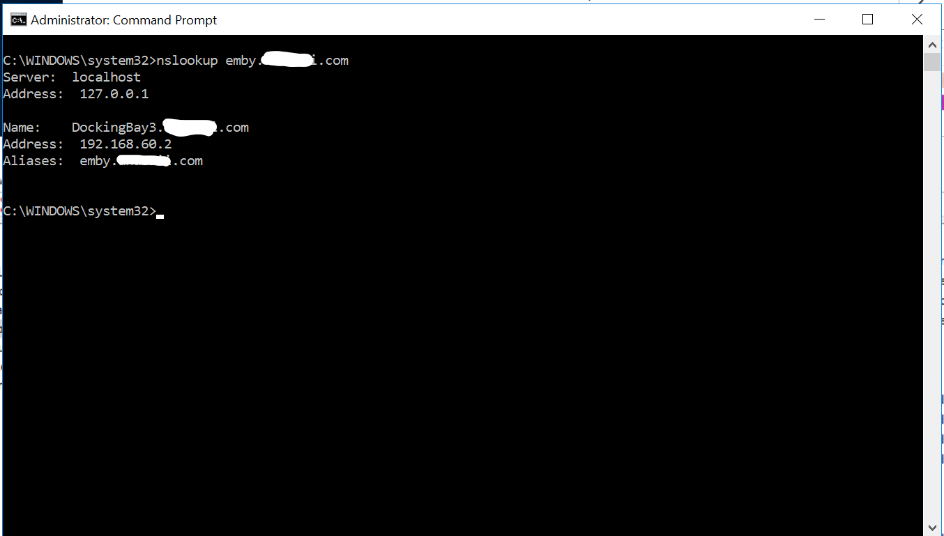

lookup from DNS server

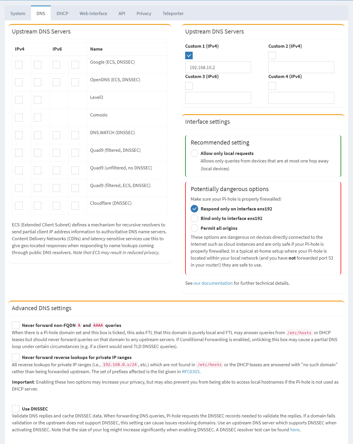

Pi-Hole settings:
look up from pi-hole host
lookup from client

Your Pi-hole is using just one of them as upstream:
    PIHOLE_DNS_1=192.168.10.2
As its Pi-hole's only upstream, any public address results are coming from that source.
