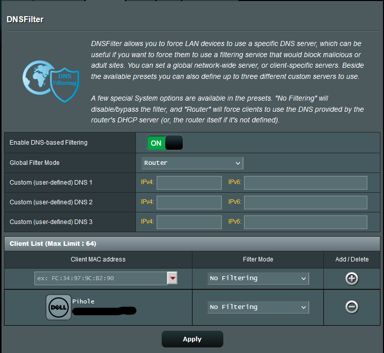

You need a router which supports this feature. In the router you will configure a rule to intercept DNS traffic and redirect it to the Pi-hole's address. You also need to make sure that the Pi-hole's address itself is exempt from this rule so that the Pi-hole can query its upstream servers.

My Asus Router has this option
That setting, when set Global filter to Router is supposed to force all devices to use whatever DNS the router has and it works great... But, this doesn't work when I set for all devices to use Pihole by adding the pihole IP on the LAN DCHP of the router... if I do that, then all devices are routed to the Pihole and everything works great.. except, now any device can easily bypass the Pihole because the Router's rule doesn't appy anymore.
The best solution is, typically, to go into your router's firewall and rewrite all port 53 UDP access to your Pi-hole (the Pi-hole itself needs to be excluded from this rule). This will catch traffic that tries to bypass your Pi-hole and ensure it is processed by your Pi-hole, too.
If your router is not able to do this, an alternative is to block all port 53 UDP to the Internet for all devices (the Pi-hole itself needs to be excluded from this rule, too). This will not catch traffic that tries to bypass, but, at the very least, prevent this from working.
