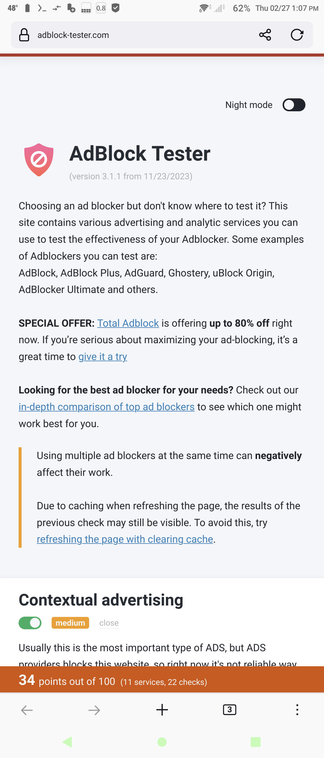

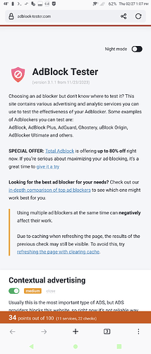

i get 98% blocked testing from the rpi4 ad block test and 34% on my android.
something isnt right, so i tried this guide see if it helps adblocking on the droid, still at 34pts.

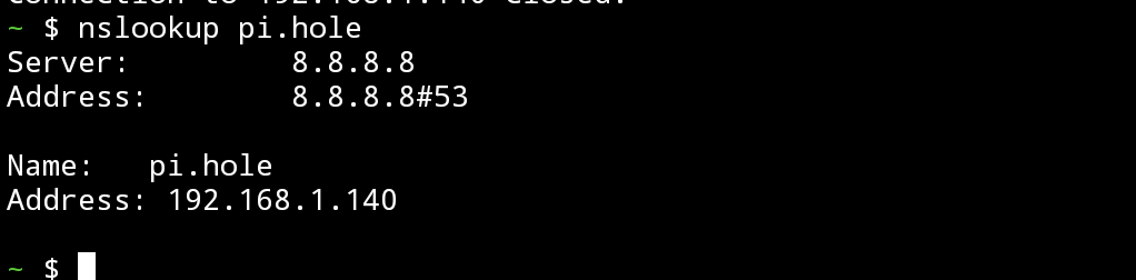

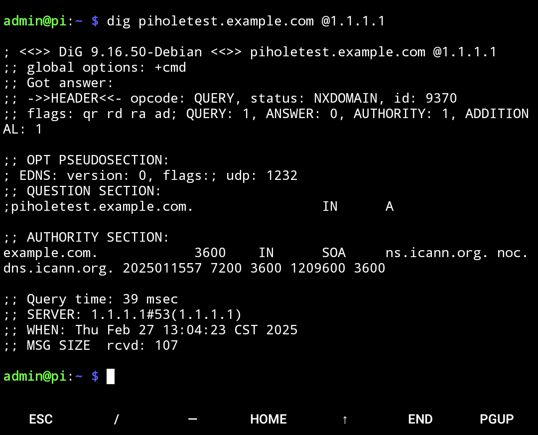

also in the guide dig response on rpi4 is hitting 1.1.1.1@53 not in the way it should as in screenahot.
I am not a fan of masquerading network traffic unless you really know what you are doing. It complicates things, and often leads to incorrect assumptions. For example, in your nslookup screenshot, it says that you are asking google's DNS for your local pi-hole. Google should not have any clue what that IP is, but because of the masquerading, it forwards to your pi-hole and it looks like google responded.

This may be due to IPv6 traffic from your phone. You'll need to perform the same port-forwarding/blocking steps on the IPv6 firewall. This is a speculation, however.
  1. The Adblock tester does not help you with firewall problems
  2. If you redirect all DNS related traffic you have to do it completely (for ip4/6)

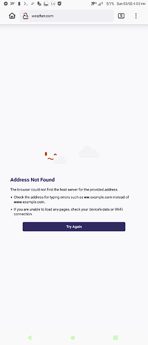

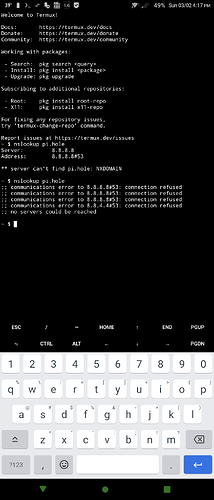

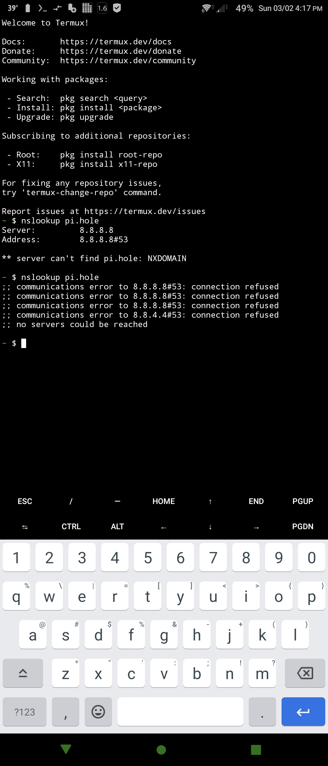

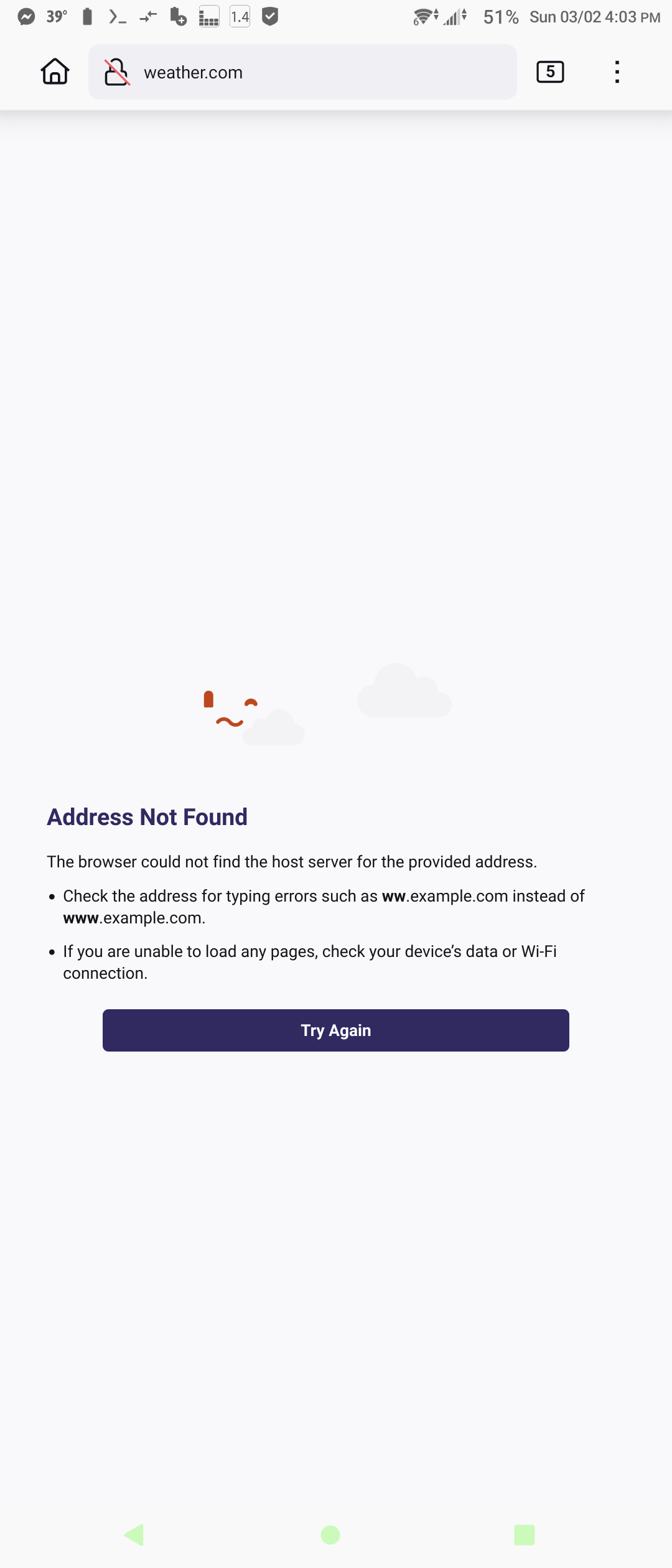

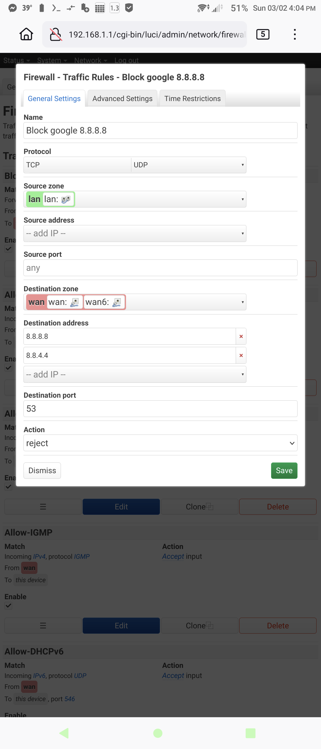

Thank you ppl, i deleted all the rules. if i read correct, it aim't correct.
this what i did and tested, setting any device to 8
8.8.8.8 8 8.8.4.4
and it works :+1:
i know its not the rigjt forums but :rofl: 8.8.8.8 n
4.4 blocked :rofl:
