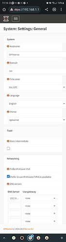

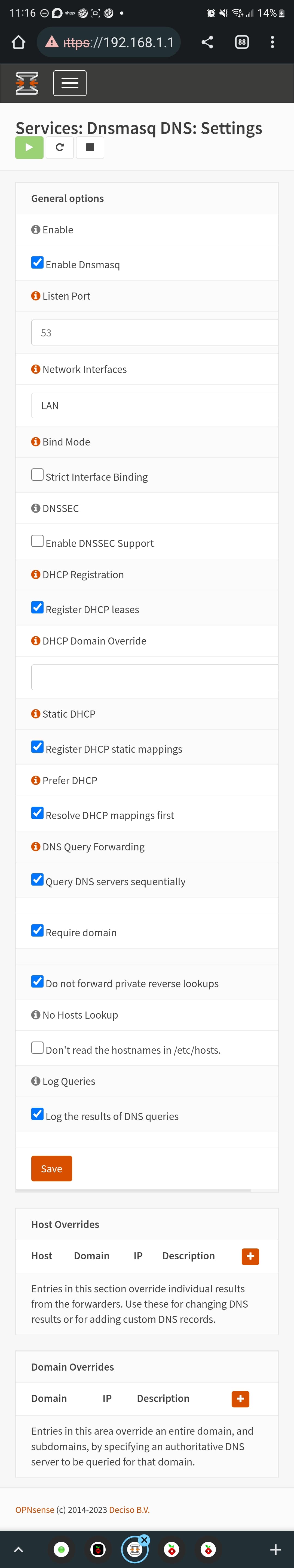

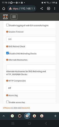

The issue seems to be this section:
"This next step configures OPNsense to send it’s own IP address as the DNS server for client DHCP leases. This uses the dnsmasq that we configured in the previous step. The example OPNsense router’s IP address is 192.168.88.2. Set this value in “DNS Servers”."
So in my world, I tried setting to 192.168.1.1 but it doesn't like this. If I change this to 192.168.1.3 the internet opens up again. I know this is not the intended setup but I can't figure out where I am going wrong.

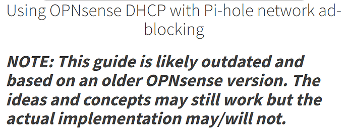

Just a quick note, that guide probably isn't going to work.
