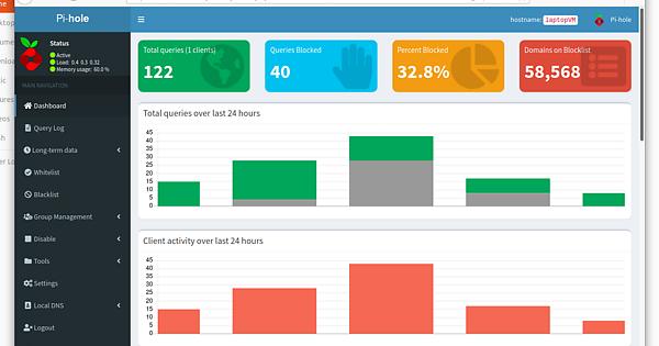

My devices don't connect to it and the pi-hole's dashboard doesn't show more than 1 (localhost). I've done my best to include everything I think you need to help me.

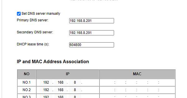

Edit: fixed typo of my pi-hole's ip and through some console commands i've found the ability to change my DNS server. So i have enabled my router(&disabled pihole) as my DHCP server and put the ip of my pihole as the primary & secondary dns servers, but this just leads to not being to open any websites (it can't find them). I've also done my best to go through my router's security settings to find possible problems. Also im usint ubuntu as a Vm. Here are some new screenshots some new pics regarding pihole - Album on Imgur.

Hi! After some researching I found a way to show my dns setting through some console lines. So i've tried something new and disabled my pihole's DCHP server and instead enabled my router as my DCHP server. This just leads to me not being able to open any websites because i guess the devices can't connect to the pi-hole?
Here are some new screenshots:
PS. I'm also new to networking in general and so I have no idea for example why i would have to different ip ranges? Maybe something to do with hamachi or zerotier?
