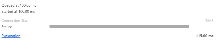

Thats what I get from that. The page definitely takes longer than 115ms till it arrives. :thinking:
Hm, that looks like your browser is stalling for 100ms and then the query takes 15ms. Are you running any extensions? Try that check a few more times to see if it always stalls for ~100ms, or if it's more random. That time might be the time til first byte, so the PHP backend would still be processing and generating the page.

The Chrome documentation specifies this about the "Stalled" phase:
  • There are higher priority requests.
  • There are already six TCP connections open for this origin, which is the limit. Applies to HTTP/1.0 and HTTP/1.1 only.
  • The browser is briefly allocating space in the disk cache
https://developers.google.com/web/tools/chrome-devtools/network-performance/reference#timing-explanation
