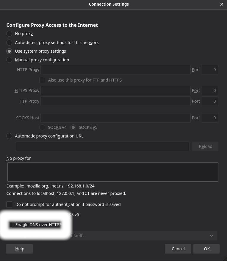

Let's check whether Pi-hole correctly returns NXDOMAIN for the canary domain:
nslookup use-application-dns.net
If it does, Pi-hole is wroking correctly, and it's likely that Firefox is configured to always use DoH / Trusted Recursive Resolvers regardless.
Try to disable DoH in Firefox via Options/Preferences > General > Network Settings and/or check the trr.mode.

Checking out the Firefox settings now. Now that you mention it I think I may have selected an always use DoH option...
Disabling the DoH setting, seems to have done the trick.
Does Firefox enable this by default now? What is stated here may be true but ONLY if you manually intervene in your firefox settings (assuming it is the default setting). DNS over HTTPS (DoH) FAQs | Firefox Help
Sort of. It is the default in Firefox, but it respects the canary domain. It is only when you toggle this setting and deliberately select DoH that Firefox ignores the canary domain and does what you specified.
I think this is consistent with what I saw. But I'm pretty sure they have a pop-up now, which if you respond yes to, it turns on using DoH all the time. And it does seem to bypass the canary domain. Pop-up comes from the either the lock or shield icon next to the Firefox search bar.
