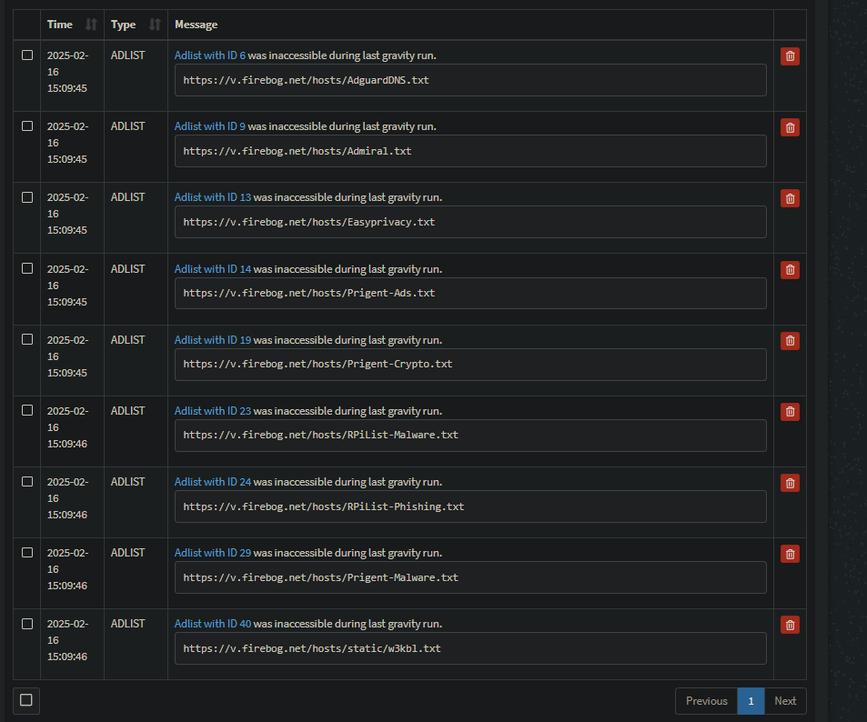

Hi, have an issue with updating Firebog lists (others work fine).
## Expected Behaviour:
I expect that when I run the gravity update, all adlists—including those hosted by Firebog (e.g., https://v.firebog.net/hosts/static/w3kbl.txt and https://v.firebog.net/hosts/AdguardDNS.txt)—should be successfully retrieved and parsed.
  • Operating System: Debian GNU/Linux 12 (bookworm)
  • Hardware: Raspberry Pi
  • Pi-hole Version: v5.18.4
  • DNS Setup: Using unbound with local DNS as configured in /etc/pihole/setupVars.conf
  • Networking: Utilizing Tailscale for network connectivity
## Actual Behaviour:
When updating gravity, all adlists update correctly except for the Firebog lists. The logs show a "Connection Refused" error for the Firebog URLs. For example:
[i] Target: https://v.firebog.net/hosts/static/w3kbl.txt
[✗] Status: Connection Refused
[✗] List download failed: no cached list available
Tested with UFW disabled, but the issue persists.

Thanks for the answer, but still not able to update them via pi-hole, curl request from raspi is also unsuccessful:
curl -O https://v.firebog.net/hosts/AdguardDNS.txt
  % Total    % Received % Xferd  Average Speed   Time    Time     Time  Current
                                 Dload  Upload   Total   Spent    Left  Speed
  0     0    0     0    0     0      0      0 --:--:--  0:01:18 --:--:--     0
But I'm able to open it from my Windows machine.
