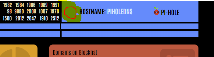

I'm using the LCARS interface/GUI and I'm seeing it in the marked location (although I've restarted and it's cleared). I'll see if I can grab one if/when it does it again. It has a warning triangle and a notification count.
