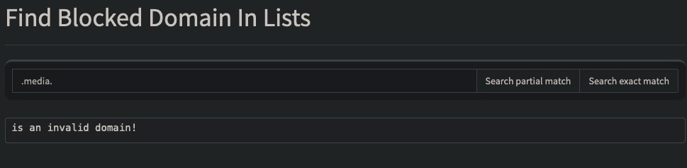

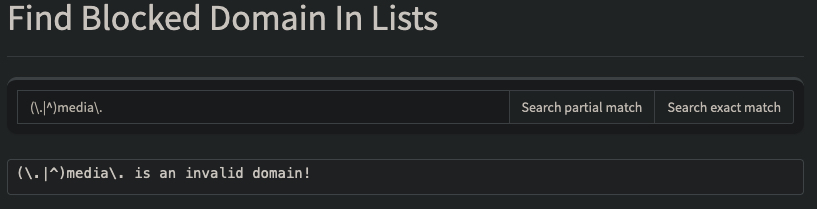

Is it possible that you can expand on the search parameters by including regex search patterns as well, for example "(.|^)media." a simple word or domain is limited.
Please provide an example of where this is limiting.

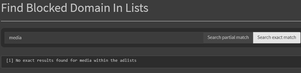

I have a text file of my own making which has some 2.5million domains that are blacklisted from various providers, which is not feasible for Pi-Hole. However, I use this list to produce regex filters for pi-hole, which catches more blacklist domains than the stock pi-hole standard blacklist. If I type the word "media", one would expect "media" only words, not every word with media as part of the whole word as it does in pi-hole.

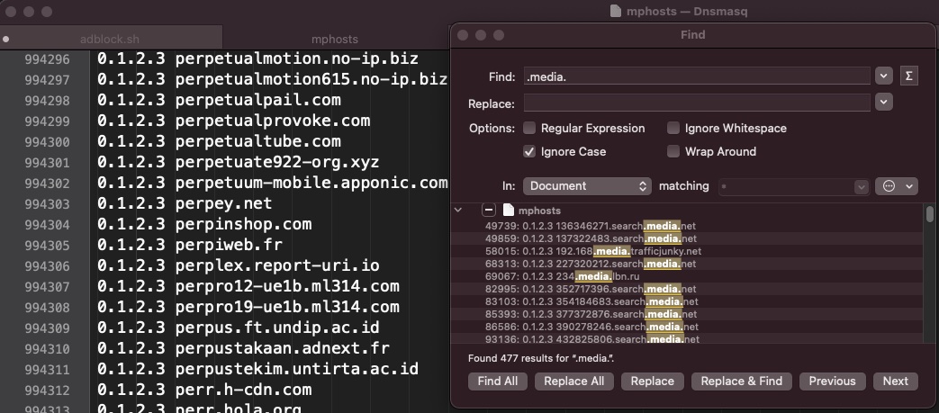

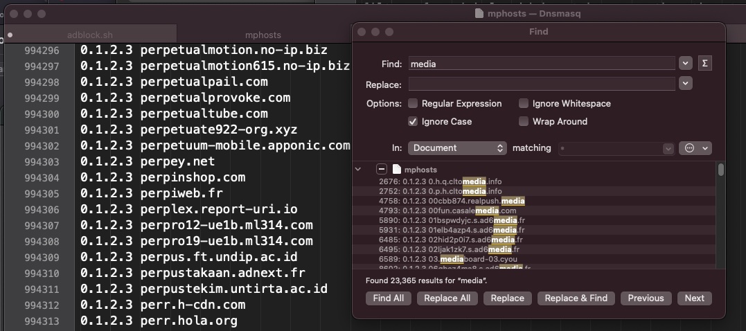

For example, if I type ".media." without the quotes as a sample in my blacklist file, it will show 477 domains hits with the word ".media." in it. But if I remove the dots and type the word "media" again without the quotes, then the result balloons out to more than 23,000 hits. As shown in image 2A and 2B in the link provided, my view is that Pi-hole suffers when the user doesn't have the ability to narrow the search parameters for a given word.
I was hoping the programmers could give the user the ability to either narrow or expand the search patterns in pi-hole, you have two modes of search, full domain or any word.

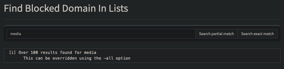

Isn't that what's already available?
See sample output from Tools|Search Adlists:

The answer is no, pi-hole search pattern is only two modes "full or part domain" or "a word" which encompass any word with that word within, which is too broad. When you look at my list, look for the word "Found" in the image and compare the differences between 2A and 2B.

All of your adlists are stored as local cached files in directory /etc/pihole. Grep on that directory with your desired search term and Linux will quickly show you the results.
As an example (running two adlists on this Pi-hole):
grep media /etc/pihole/list.* | wc -l
11894
grep '.media.' /etc/pihole/list.* | wc -l
11019
grep '.media.net' /etc/pihole/list.* | wc -l
365
