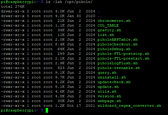

What's the output of
ls -lah /opt/pihole/
Should the FTL have been updated to V6 automatically?
The output of ls -lah /opt/pihole/ is:

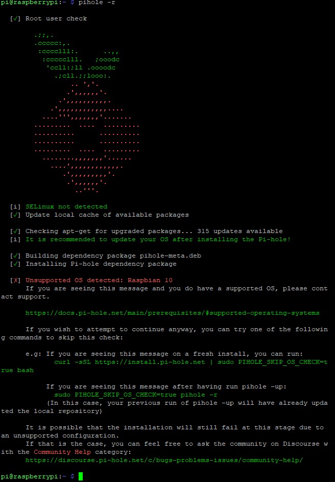

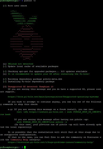

Ive also tried pihole -r with this result:
It took over five hours for this operation to finish...

Your system is running on Raspberry Pi OS 10/Buster, which Pi-hole doesn't support anymore.
Debian/RaspberryPi OS 10 (buster) has reached EOL in 2022 and LTS was discontinued by June 2024.
You may try to upgrade to Pi-hole v6 with the steps you've quoted from the installer above, but there's no guarantuee that this would succeed, and its OS won't receive security upgrades anymore.
You should upgrade your OS release.
Note that Raspberry Pi OS documentation discourages in-place upgrades to a new OS release, proposing to image a new SD card instead:
Warning
Before attempting a major version upgrade, make a backup.
To update the operating system to a new major release on your Raspberry Pi, image a second SD card with the new release. Use a USB SD card reader or network storage to copy files and configuration from your current installation to the new SD card. Then, swap the new SD card into the slot on your Raspberry Pi, and boot.
With that approach, keeping the old sd card would serve as a backup, allowing you to return to your Pi-hole v5 installaton by swapping the old sd card back in.
You should start on your current system by backing up your Pi-hole v5 configuration via Settings | Teleporter.
You could then shutdown the system and slot in an sd card with a freshly imaged OS from Raspberry Pi OS downloads – Raspberry Pi. Currently, that would be based on Debian 12 (bookworm).
After that, install Pi-hole v6 as usual, and then import the Teleporter backup.
