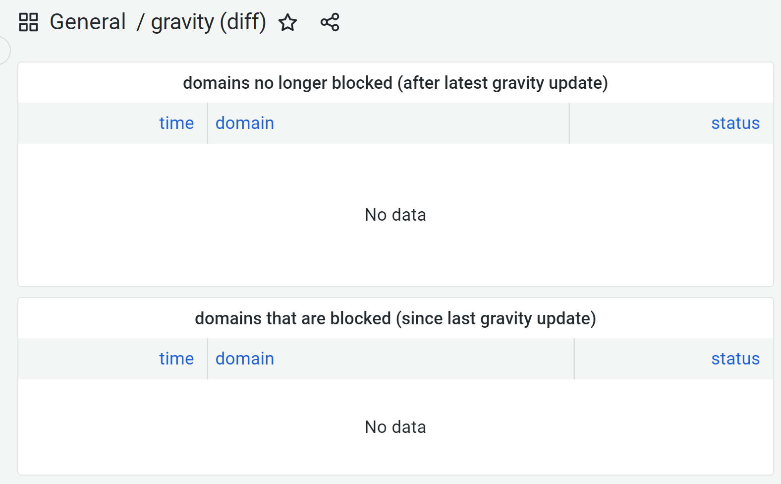

I've been using the old database to be able to see the diff between last week and this week; depending on the number of lists, this can be useful info, but often, the diff is so large (many lists), it is hard to conclude something useful.
It's much more interesting to compare the diff with the existing query log (database)
  • domains that used to be blocked, but aren't anymore.
  • domains that used to be allowed, but are now blocked.
Note this result is based on query database, so the impact is real.
sometimes, not often, there are some real suprises in the result, some even require immediate action...
We're not allowed to list code here, but on the dutch forum, I've listed the queries I've been using to get this result. I'm using grafana to visualize the result, since expanding the pihole web interface isn't really an option (requires redo after every update)

the diff from today (gravity ran last night), nothing to show after this run...:

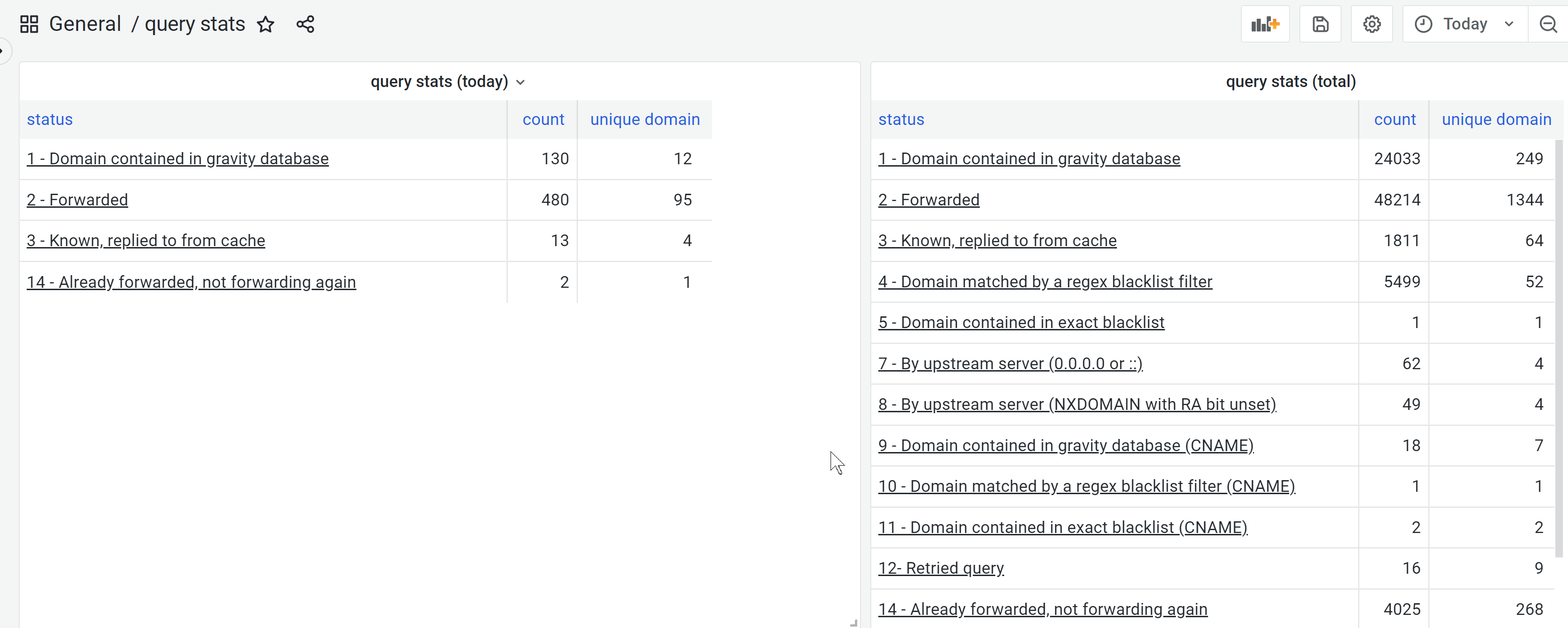

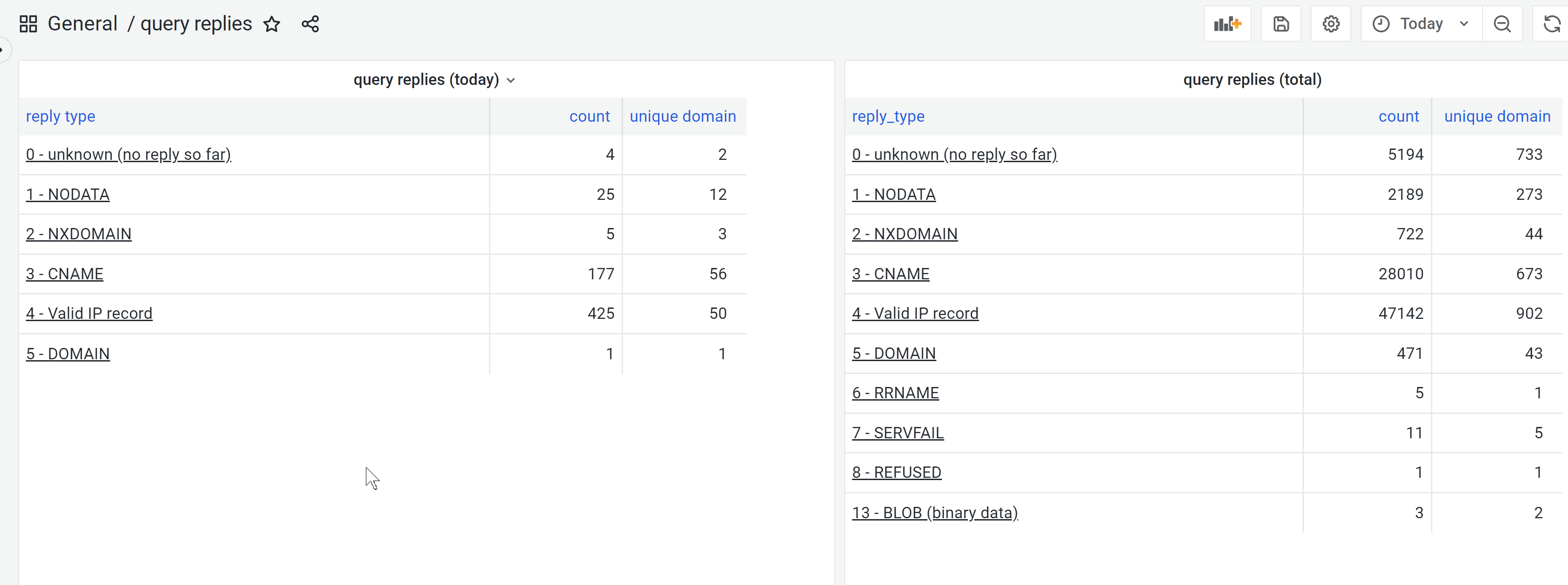

some other grafana dashboards, using this plugin:
edit
  • keep in mind that I use MAXDBDAYS=8, no idea what the response time will be with a 365 days db.

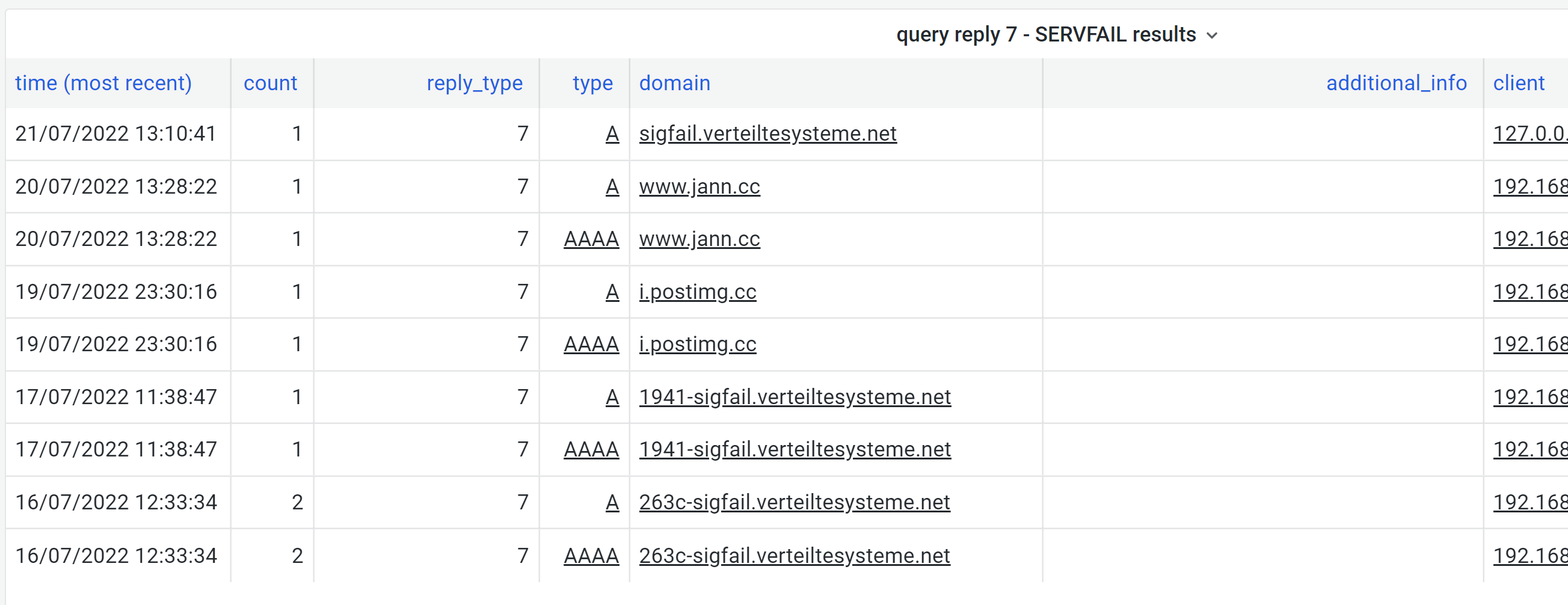

  • the underlined items in the above screenshots are links to other dashboards, so if I click on the SERVFAIL link, I get the details:
you'll recognise some of the domains (result of testFTL script I run after an update / fresh install to verify FTL is doing everyting it should - you are using PowerDNS to do this). The cc TLD is considered bad by suricata, thus dropped (on the firewall), result -> SERVFAIL
details for a specific domain? again, click on the link -> other dashboard
