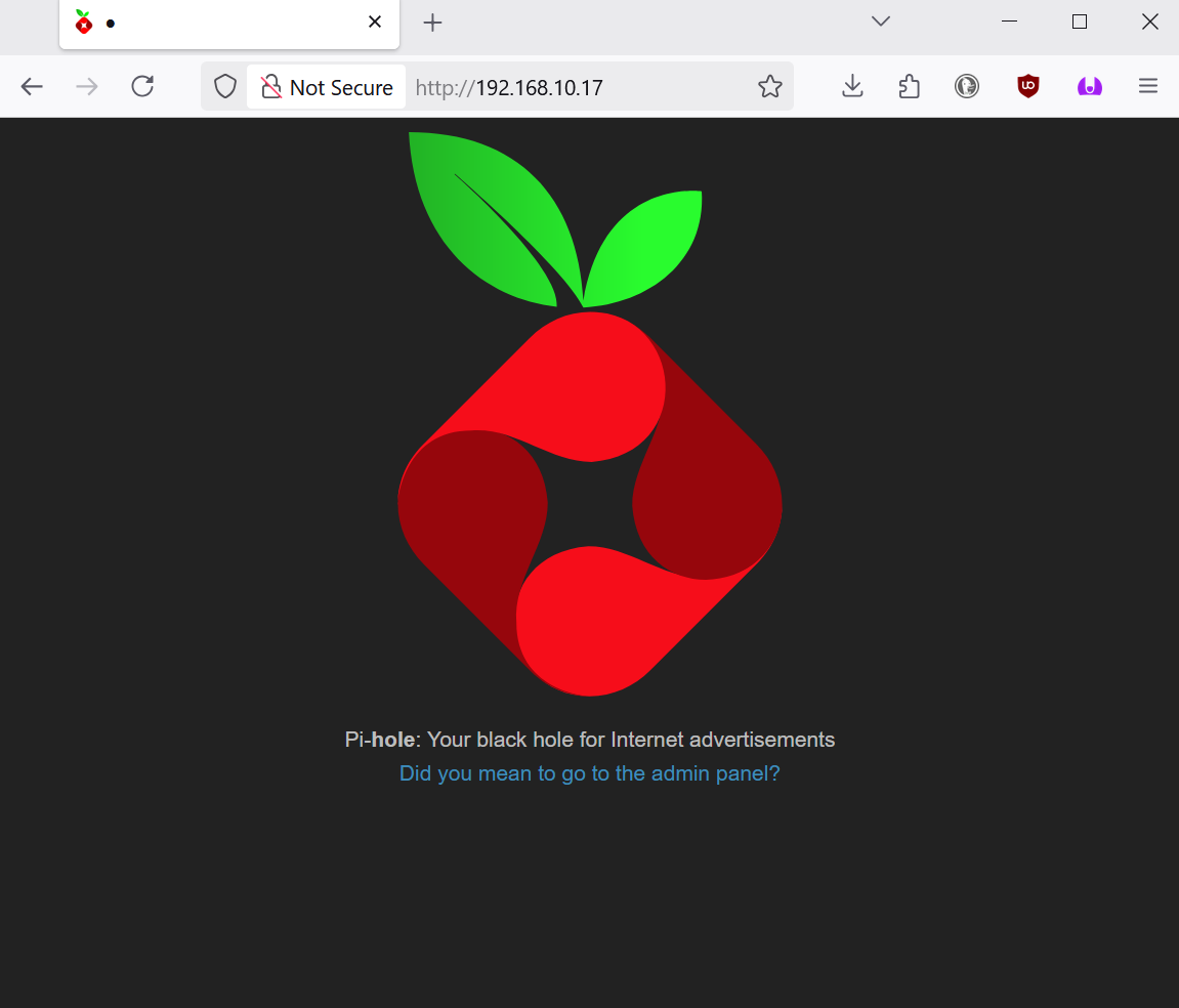

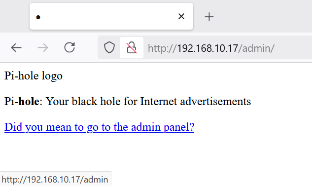

Web admin page stuck in forever loop. When I visit http://<pi-hole ip address>/admin, it displays this:
If I click the "Did you mean to go to the admin panel?", it just reloads the same page. Because that link actually direct to this exact url (see the bottom right, that's the url when I hover my mouse on it).
If I just visit http://<pi-hole ip address>/, it takes me to this page. If I click the link "Did you mean to go to the admin panel?", it takes to the page in the above screenshot again. This is just a infinite loop.

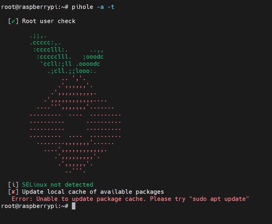

pihole -a -t
pihole-FTL --teleporter
My pi-hole is running on a old raspberry pi in which the OS version (buster) is no longer being updated. I tried to update the pi-hole but ended up in this situation.

pihole -a -t is the Pi-hole v5 command to create a backup.
If you already did that before trying to update, you have a backup file containing all your Pi-hole v5 settings. Keep this file to use it after you install Pi-hole on a new OS.
If you didn't create a backup before you get into the "mixed" version state, then I'm not sure what will happen if you try to create a backup now, but you still can try pihole -a -t (it worth a try).
After you install Pi-hole v6 on a new OS, you will be able to use this command to restore the settings: pihole-FTL --teleporter <previously_created_teleporter_file>.
