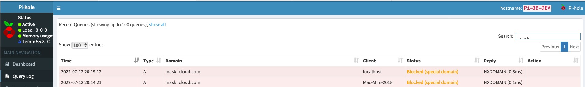

Please run a quick check for me. From the client that is having Facebook issues, and from the terminal or command prompt on that client (and not via ssh to the Pi), what is the output of the following:
nslookup mask.icloud.com
The answer should come back as NXDOMAIN, since that is how Apple checks the DNS resolver to see if PR can be run.
In the query log, you should see the domain blocked as a special domain:
Server:		192.168.0.2
Address:	192.168.0.2#53
** server can't find mask.icloud.com: NXDOMAIN
