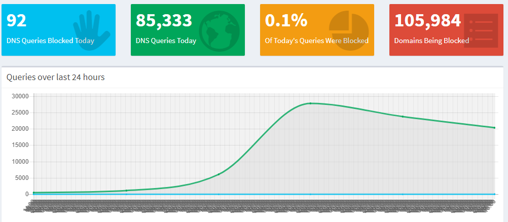

Zero luck on my end, every device is blocked, and my router is blocked as well.
Nothing is sent back, but the queries are logged. Seems there is a DNS pb for sure.
There is something wrong about the queries though, the time is completely messed up (showing 1494609479 for today), it seems there is a huge amount of queries that cannot be flushed (70.000 entries as I just flushed the log)
- Updated to 3.0.1 from 2.11.1 did nothing, I'm gonna try flushing the app completely from the Pi side and try again...
