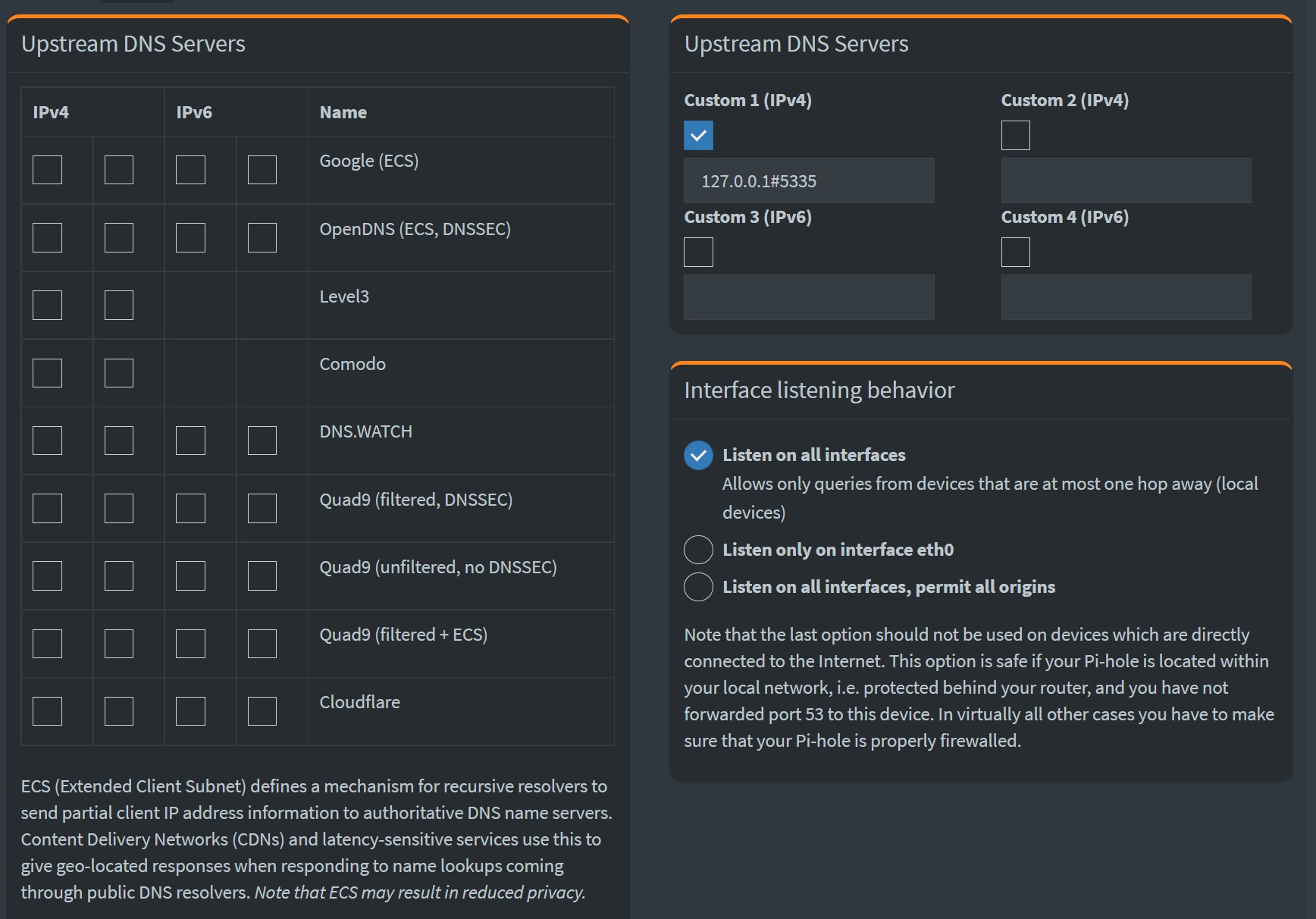

Question regarding FritzBox Help Fritz!Box (EN) - Pi-hole documentation and Upstream.
This is my DNS config. Can I safely assume FritzBox is not an Upstream server here since as I understand only unbound is the upstream?

While your screenshot shows that unbound is indeed your Pi-hole's sole upstream server, your FB could still be used upstream if your unbound would be configured to use your FB.
That would not be the case if you've followed our unbound guide - unbound would be running as a recursive resolver then.
