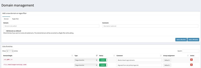

I'm not seeing the behavior you describe on any of my running Pi-holes, on several different browsers. It is only when I narrow the browser window significantly that this column becomes difficult to read:

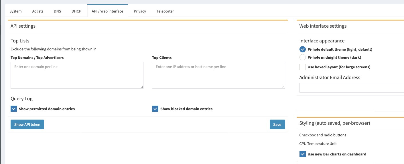

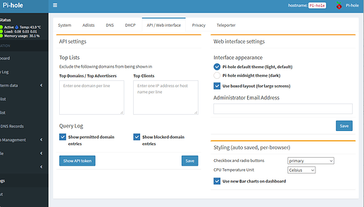

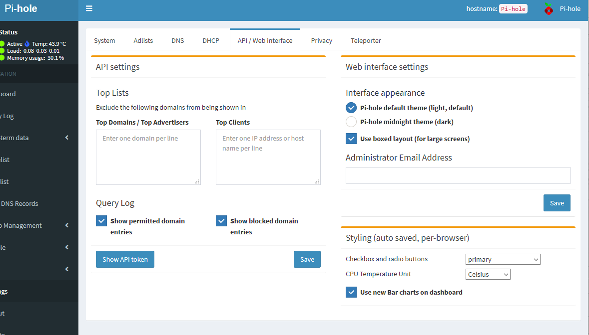

Even though your browser is set to full screen, if you are using the boxed layout for the Pi-hole admin GUI, the page you are viewing won't use all the screen real estate.
On the Settings > API/Web Interface page, deselect the "Used boxed layout" and save the change; this should resolve your problem.

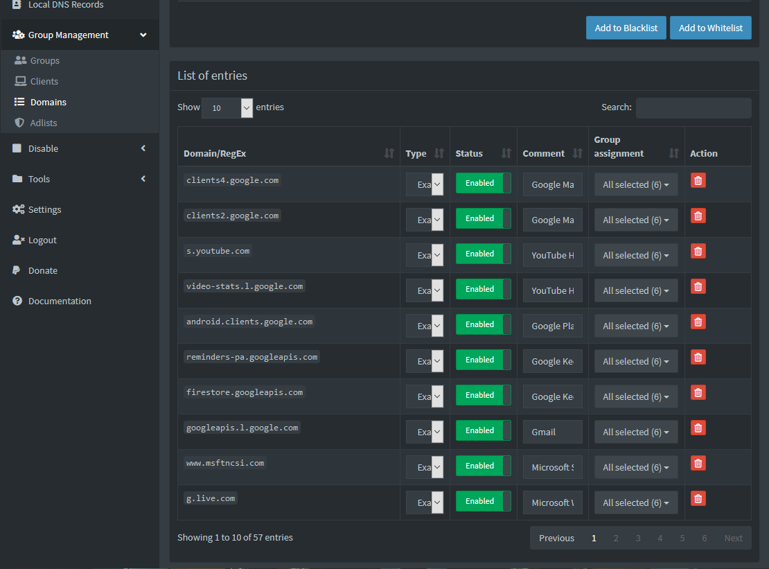

(at)jfb Thanks this did fix the issue for when my browser is full screen since it got rid of that unnecessary margin. I will say though that the Type column seems to aggressively shrunk and I'm not sure why.

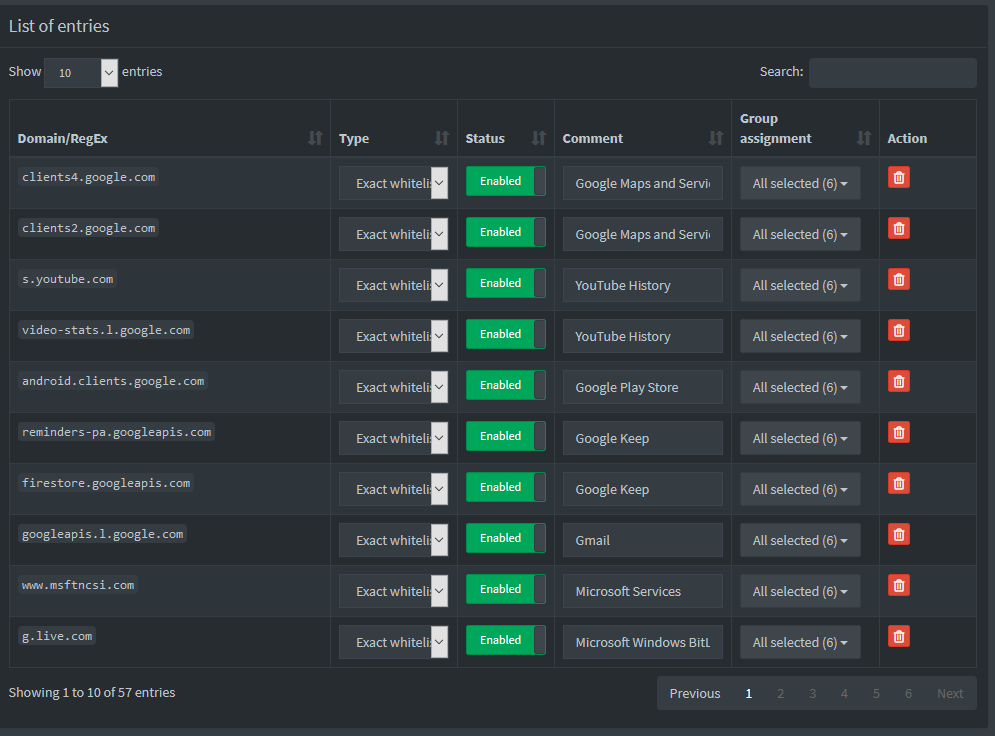

Example:
You can't see that they are all "Exact Whitelist"?
What layout are you using? (Boxed or unboxed)
At some point if the window isn't wide enough to display everything, some elements will have to shrink. It is likely we can improve how the sizing works for each column relative to the others. I would keep your browser window at maximum width for now.
(at)DanSchaper. When I put in the ticket it was more compressed and I should have posted a screenshot. See the screenshot in my second reply for a better example.
I'm not sure why it was more spread out now. Yes.. in that screen shot I can certainly infer that the type. But that being said, based on the size of the contents of the various fields there's no reason for it to be collapsed at all.

It is exactly the same issue. The width of the columns is calculated for the whole table not only the fist page. Select "All" in the drop-down and you will see.
In your case it is likely the entry xboxexperiencesprod.experimentation.xboxlive.com that causes this issue.
Fixed by Fix layout on small screens for some datatables by rdwebdesign · Pull Request #2078 · pi-hole/web · GitHub
