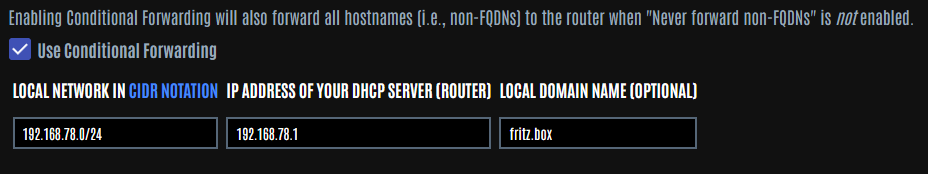

I filled in the "fritz.box" in my local domain settings:
Should then the "local permitted domains" be excluded from the statistics?

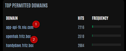

Sorry, i meant instead of "192.168.78.10" I started to use "openhabmain.fritz.box". I meant "me - switching to not remember IP-addresses anymore" :wink:
And then I'll get this, which kind of scrambles my dashboard, because local domains should always be "permitted" I guess?
(1) this is an external domain (for my Niu e-scooter API)
(2) these are internal devices/servers, which I use throughout my local network
I guess this would involve using names instead of IP addresses in third-party software configuration?
