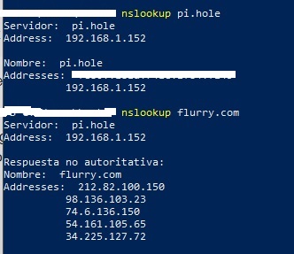

This is an indication that either the Chrome browser or the client on which it is running is not using Pi-hole for DNS.
From the client on which Chrome is running, from the command prompt or terminal on that client (and not via ssh or Putty to the Pi), what is the output of
nslookup pi.hole
nslookup flurry.com
I would say that this is correct, what I am generally seeing now is 0% blocked traffic, I don't understand what must be happening, one problem after another is created. I have released the domain "eu.api.miwifi.com" and I have been browsing for a while and I am still at 0% blocking.
Pihole obviously has a static IP and is configured on the router as a DNS server.

Your debug log shows you created 3 groups with IDs: 0, 1 and 5.
It also shows all your lists are attached to group 5, but no devices are using this group.
Your devices are not using any adlists and nothing is blocked.
It is not. One would expect flurry.com to be blocked by Pi-hole, as it appears on almost every public blocklist.
As rdwebdesign noted, you have all your adlists assigned to a group (5) that contains no clients, which means you have effectively disabled Pi-hole blocking for all network clients.
@Bundy to fix the problem with your groups I would suggest you put everything back into a single Default group and start again. You are only using one group now (the "wrong" one as advised by rdwebdesign and jfb) so you won't lose anything by doing this.
