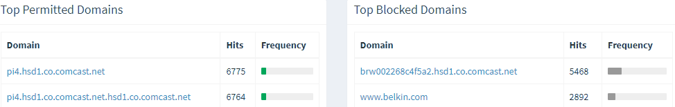

The blacklisted domains (4 and 5 below) are the top permitted domains.
pi@pi-hole:~ $ pihole -b -l
Displaying blacklist:

pi-hole is a recent bog-standard install on a pi 3b+. The pi4 in question is running Raspbian 10 (buster), and is used primarily as a SMB file server for a couple of external drives, and has a small web server using Python bottle and rocket to serve some local files. It doesn't do much else. If my image posts right, you can see the blacklist works on domains 1 and 2 in the list, but not on 4 and 5 (the pi 4).

The last two domains in your domain list are not assigned to any groups, thus are not effective. Assign them to the default group.
   id     type  enabled  group_ids     domain                                                                                                date_added           date_modified        comment
   7       1          1  0             wpad.hsd1.co.comcast.net                                                                              2022-07-11 14:07:01  2022-07-11 14:07:01
   8       1          1                pi4.hsd1.co.comcast.net.hsd1.co.comcast.net                                                           2022-07-12 11:13:02  2022-07-13 20:56:47
   9       1          1                pi4.hsd1.co.comcast.net                                                                               2022-07-12 11:13:13  2022-07-14 16:46:44
