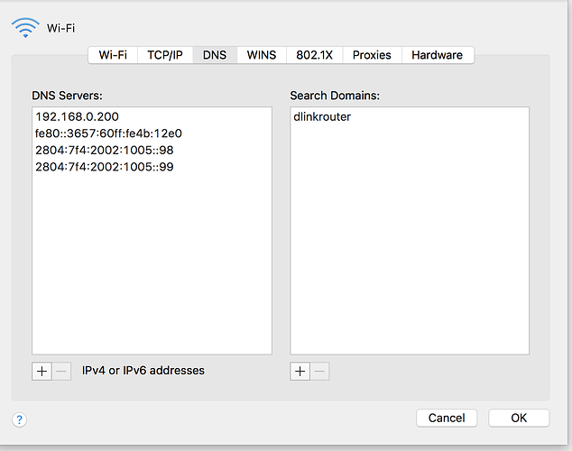

Perform DNS queries on pi-hole
Performing queries on my ISP delegated DNSs
dcwv6mxkvi
As you can see, my raspberry (pihole) is the first delegated DNS ip:
But somehow when I run
nslookup it uses another dns provider:
➜ ~ nslookup google.com
Server: 2804:7f4:2002:1005::98
Address: 2804:7f4:2002:1005::98#53
Non-authoritative answer:
Address: 172.217.30.78
ANd here you can see it works, but calls don't go through it
➜ ~ nslookup google.com 192.168.0.200
Server: 192.168.0.200
Address: 192.168.0.200#53

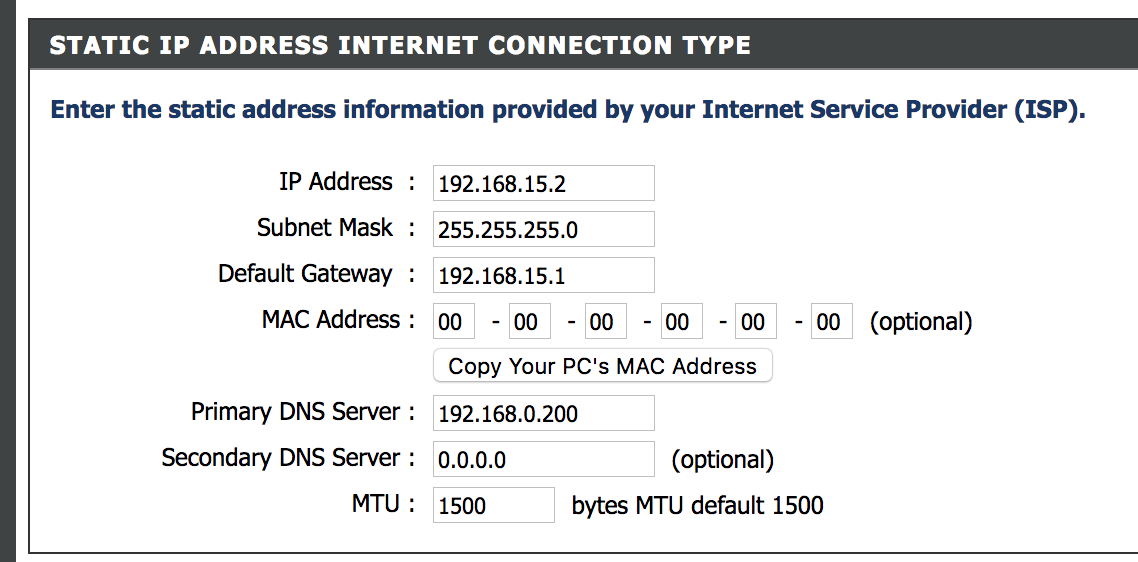

I understand, and that's exactly what I'm trying to accomplish: have pi-hole as the only delegated dns.
I'm not delegating any others:

Maybe I'll have to use pi-hole own DHCP service.. Because i can't force it to be the only available dns provider
Use
scutil --dns
and that will show the true order of your resolvers. The GUI is often misleading despite it being set properly. In addition, you probably want to have only the Pi-hole set as your DNS, per the link @DanSchaper provided.

But I don't know how to force pi-hole to be the first/only in that list.
Yep, so your Pi-hole (192.168.0.200) is actually the last resolver to be queried. Setting it as the only available resolver should fix the issue and force all queries to go through the Pi-hole.

Yes, I got that.. I just have no idea how to do it.. maybe it's out of reach?
From the GUI in your screenshot, you need to highlight the other DNS servers and click the minus sign to remove them.

Actually they are auto-assigned, I haven't added them.
I can only do that if I manually configure the dns providers, which misses the point of having pi-hole..

After some more tweaking with both routers in the network I was able to set pi-hole as the only resolver. Everything seems to be perfect now.
