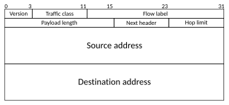

[Few queries to an NTP server.]
[Every 2 minutes, both Raspberry Pi's in my network are querying 0.debian.pool.ntp.org queries. ]
