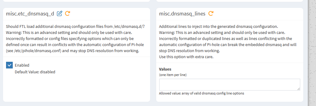

With the latest Pi-hole Docker Release 2025.06.0 · pi-hole/docker-pi-hole · GitHub, I can confirm your issue.
With the following lines added to misc.dnsmasq_lines:
rev-server=192.168.2.0/24,192.168.2.1
server=/fritz.box/192.168.2.1/
server=//192.168.2.1
server=/_msdcs.fritz.box/192.168.2.1
The resulting dnsmasq.conf looks like this (click for details)
