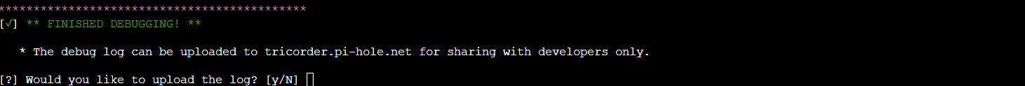

I entered pihole -d command in terminal, get a long text but cant find token url :thinking:
When the "long text" is finished, did you see this question?
[✓] ** FINISHED DEBUGGING! **
[?] Would you like to upload the log? [y/N]
Please answer Y and wait for the token.
No, i get this.
  • The debug log can be uploaded to tricorder.pi-hole.net for sharing with developers only.
* Log will NOT be uploaded to tricorder.
* A local copy of the debug log can be found at: /var/log/pihole/pihole_debug.log
That message indicates that you didn't reply with Y when asked whether you would like to upload the log.
I never got that question.
is this because i run pihole in a docker container and not natively in raspberry pi os?
I did however copy the log output i got on my screen.
How are you running pihole -d? If you do not use an interactive session then you will not get the option. You can do a pihole -d -a for an automated debug run with uploading enabled.

Because i run pihole in docker i use the command docker exec pihole pihole -d
The run the command I showed above or add -it to your docker exec for an interactive terminal.
docker exec -it pihole pihole -d or docker exec pihole pihole -d -a
workded :slight_smile:
https://tricorder.pi-hole.net/NEEg9rh0/

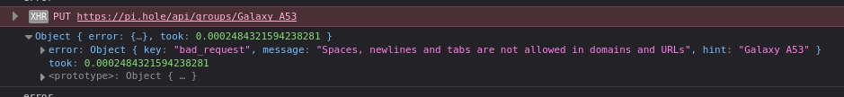

We are actually working on this issue.
Sorry for this having been overseen for so long. At the very least, I was just able to follow your instructions (create group a, then edit spaces into the name like Galaxy A53 and then try to e.g., disable the group) and can confirm this behavior:
This is a small bug in the API code processing PUT /api/groups and should be fixed by
https://github.com/pi-hole/FTL/pull/2143
Fixing being able to add groups with spaces in the very first place (enclosed in quotes) will be done by
https://github.com/pi-hole/web/pull/3187
The first of the two fixes has been merged into development
