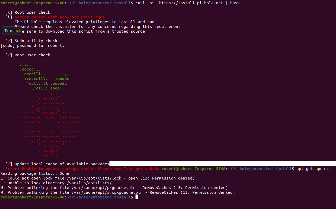

Should continue instalation
look at image attached
sudo apt-get update
And then fix the errors and warnings that are displayed from the output of that command.
and how do i do that?im new to this type of stuff
Did you type the command I showed?
yes,it said
Reading package lists... Done
E: Could not open lock file /var/lib/apt/lists/lock - open (13: Permission denied)
E: Unable to lock directory /var/lib/apt/lists/
W: Problem unlinking the file /var/cache/apt/pkgcache.bin - RemoveCaches (13: Permission denied)
W: Problem unlinking the file /var/cache/apt/srcpkgcache.bin - RemoveCaches (13: Permission denied)
That's the command I need you to run.
im sorry for taking up your time
This is an OS level issue. Fix this problem, and then the Pi-hole installer will continue normally. If apt update does not complete, the Pi-hole installer will stop.
This is probably a really quick fix. I just need you to type sudo apt-get update and then let us know what the result of that is.
i got it fixed,thanks

a bit of a problem;
it still keeps saying
Error: Unable to update package cache. Please try "apt-get update
Then you didn't get it fixed. What is the exact output from sudo apt-get update?
Ign:1 cdrom://Ubuntu 20.04.1 LTS _Focal Fossa_ - Release amd64 (20200731) focal InRelease
Err:2 cdrom://Ubuntu 20.04.1 LTS _Focal Fossa_ - Release amd64 (20200731) focal Release
Please use apt-cdrom to allow APT to recognise this CD-ROM. 'apt-get update' cannot be used to add new CD-ROMs
Hit:3 http://gb.archive.ubuntu.com/ubuntu focal InRelease
Hit:4 http://gb.archive.ubuntu.com/ubuntu focal-updates InRelease
Hit:5 http://gb.archive.ubuntu.com/ubuntu focal-backports InRelease
Hit:6 https://dl.winehq.org/wine-builds/ubuntu focal InRelease
Hit:7 http://security.ubuntu.com/ubuntu focal-security InRelease
E: The repository 'cdrom://Ubuntu 20.04.1 LTS _Focal Fossa_ - Release amd64 (20200731) focal Release' does not have a Release file.
N: Updating from such a repository can't be done securely, and is therefore disabled by default.
N: See apt-secure(8) manpage for repository creation and user configuration details.
It looks like you didn't remove the cdrom line after installing using the iso image.
You'll need to edit /etc/apt/sources.list and remove or comment out the cdrom line.
Normally that happens during Ubuntu's setup but for some reason it did not complete for you.
ubutnu wont let me as 'i have no permissions 'even after i rooted
