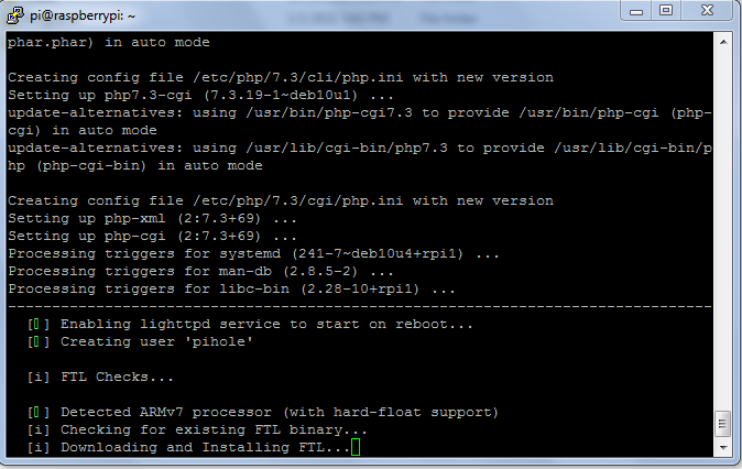

The issue I am facing:
unable to install / proceed further past downloading/installing FTL while installing Pihole
Details about my system:
Raspberry Pi3B 2GB
i was playing with Cloudflare installation, which i couldnt succeed I thought of reinstalling Pihole with Unbound and DNSCrypt proxy
But i am unable to go further pas Downloading and installing FTL, as you can see in the Image i uploaded.
I tried to update all the patches and try installing and without installing patches: everytime it stops at this stage for long time and nothing happens.
I dont know why its happening like that. need help pls.
Thanks!

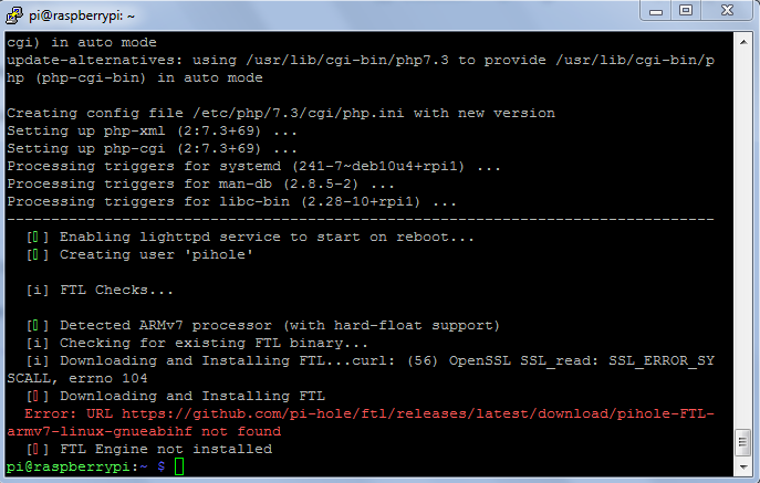

After maybe 30 Minutes, i got this error.
That's an OS level error. Not something we can fix.

See the link I just posted. It's not a Pi-hole error. It's an OS error.
Edit: Not knowing what you "patched" or "updated" means we don't know what you did.
