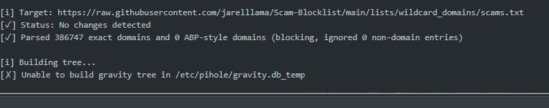

I was having a similar issue when I updated from v5 to v6 yesterday - but only on 1 of my 2 piholes. I did a whole bunch of testing with the lists - and it appeared to be an issue around 2 million domains (not unique) - and when my pihole was allocated 512MB of RAM. Updating it to 1GB or 2GB of RAM and it was successful. Happy to open a new issue if we think it's unrelated
1GB / 2GB
512MB
512MB Tricorder:
https://tricorder.pi-hole.net/aV46lmyz/
Yes, this is unrelated and sorry for the long delay in replying. I had seen your post last week but then other things came in my way and I forgot about it again...
The issue here is that we build a very large B-tree for being able to search within the 2 million in light speed. Iterating over each of the 2 million domains for each and every query processed by your Pi-hole would consume way too much time. Unfortunately, building this tree can only very limited been done in parts so a substantial amount of memory is needed for this task. 512 MB is just not enough. We also cannot really change the algorithm in any way to do this with less memory. What we can do is making the error message clearer in suggesting that this may be a memory issue:
