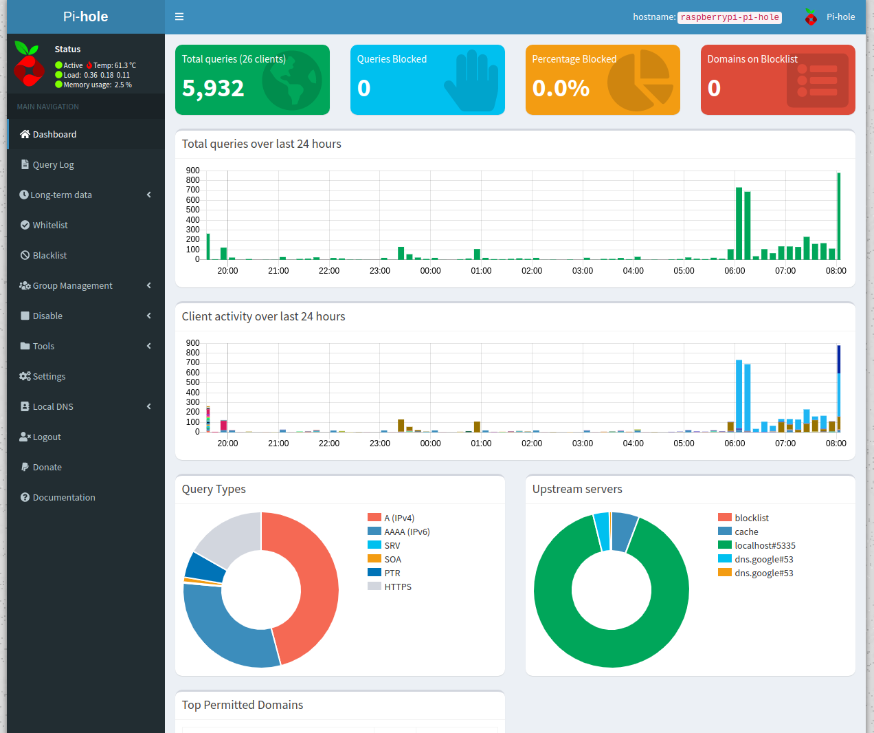

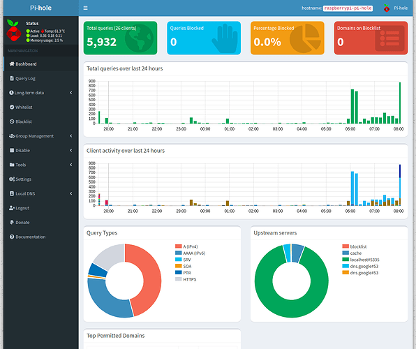

This is the administration Panel how it looks like (no Domains on Blocklist)

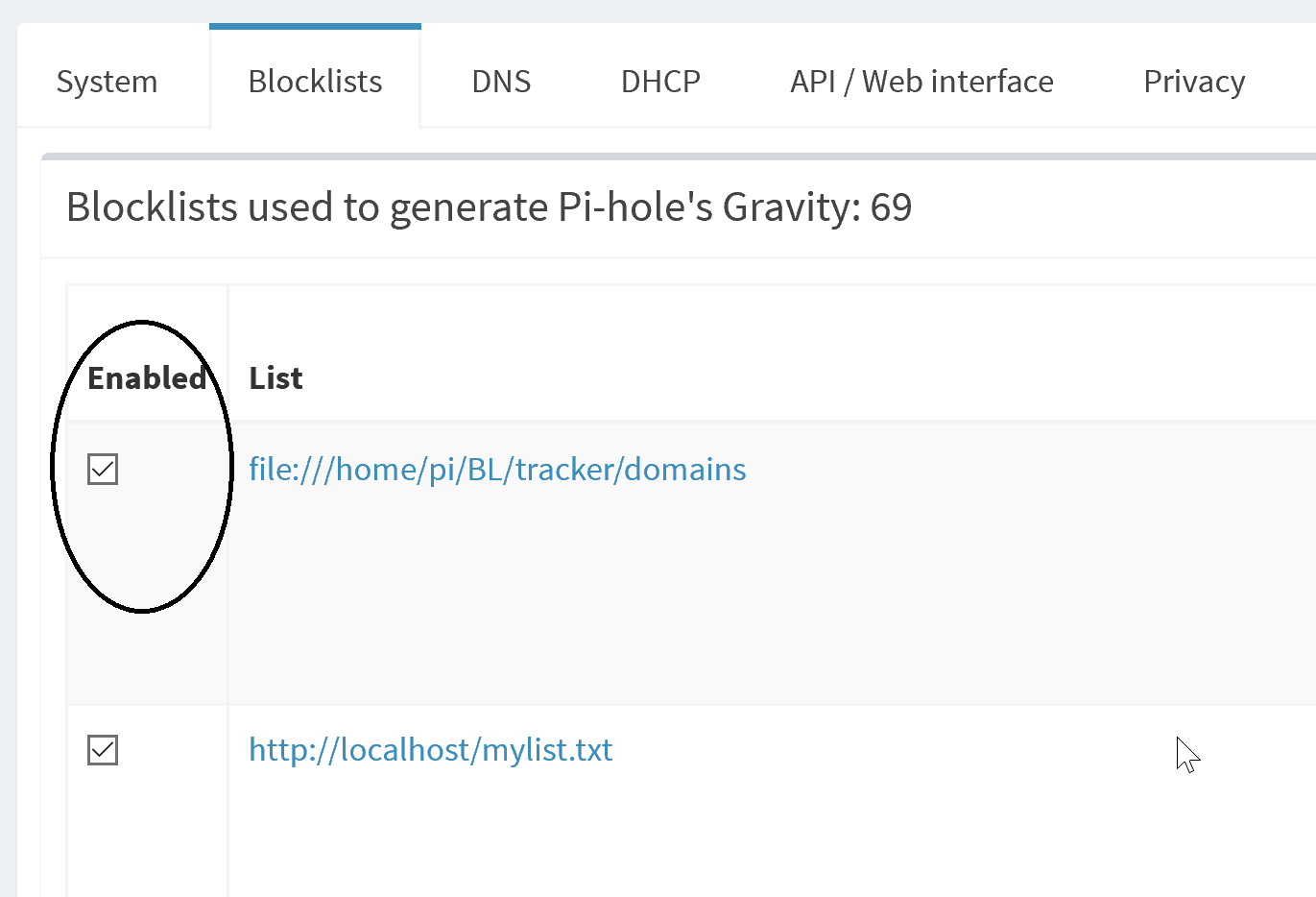

In the settings section, there is also no "Blocklists" tab as meantionned in this post:
