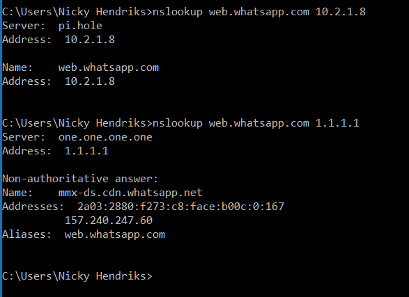

These are the results, works just fine.:
I've narrowed it down to a single blocklist regarding WhatsApp (https://raw.githubusercontent.com/blocklistproject/Lists/master/facebook.txt). Now I did a lookup (stupid I didn't think of this myself..) and it appears to be on this list. Either this list was updated or I switched to another domain in the CDN.

It's good to know it has something to do with blocklists but somewhere in the DNS response the Pi gives it goes wrong I guess. Could do a Wireshark thing if that is helpful?

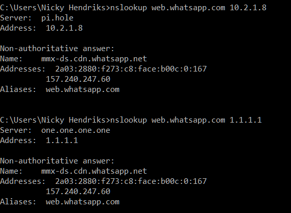

Your nslookup results for web.whatsapp.com are identical, regardless whether resolution is forced through your Pi-hole at 10.2.1.8 or a public DNS resolver at 1.1.1.1.
In other words:
Pi-hole is not blocking that domain.
Therefore, for Pi-hole to be involved, any irregularities you observe in conjunction with browsing web.whatsapp.com must implicate other domains.

It is blocking it, think I accidentally turned off the adlist that is blocking that domain during the previous lookups:
I can get around that by adding a regex or something to whitelist the Whatsapp CDN. What I still can't get my head around is the fact that I'm not getting and ERR_NAME_NOT_RESOLVED errors anymore when a domain is blocked but the ERR_ADDRESS_INVALID. As mentioned before the new error message does something with cache as well as I can't just turn off blocking for a few seconds and refresh. It takes a significant amount of time before it actually works. With nearly 4.5 million domains blocked this is no problem for most of the time but sometimes when you want to quickly disable Pihole because an ad-domain is on a blocklist then it's very anoying.
Hm. Then how were you able to still trigger the error when that adlist was turned off?
Pi-hole has no say in what a client does after a domain has been resolved or blocked, or what messages it may present.
The change you are observing may be triggered by one of your many adlists updates, or maybe you are using additional filtering/caching (e.g. dedicated firewall or web proxy), or is that client accessing Pi-hole via a split tunnel VPN?
