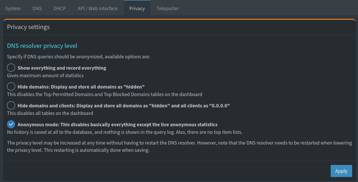

Is there a way by using an environment variable to set the privacy settings to "anonymous mode"?
QUERY_LOGGING=false seems not to work :thinking:

The query logging setting controls logging to the dnsmasq log at /var/log/pihole/pihole.log.
The privacy settings you show in your screen capture control the query log, which is saved to the query database at /etc/pihole/pihole-FTL.db.
Your selected setting is saved in the FTL configuration file at /etc/pihole/pihole-FTL.conf.
In Docker, these files should be mapped to persistent locations, to survive container restarts.

https://github.com/pi-hole/docker-pi-hole#advanced-variables
FTLCONF_PRIVACYLEVEL=XXXX
Now this is what I was looking for, works perfectly :muscle:
