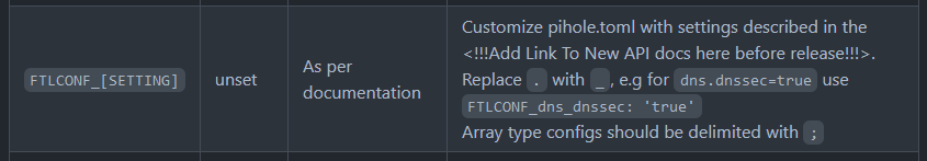

Using docker v6, what's the format for environment variables relating to the options described at Interfaces - Pi-hole documentation ?
e.g to use the dnsmasq option 'interface', I've tried:
FTLCONF_dns_dnsmasq_interface
FTLCONF_dnsmasq_interface
FTLCONF_dns_interface
FTLCONF_interface
but none of those works.

Just to avoid confusion... For the V6 docker container, the relevant Readme should be consulted, where one will note that the INTERFACE environment variable no longer exists :slight_smile:
https://github.com/pi-hole/docker-pi-hole/tree/development-v6
