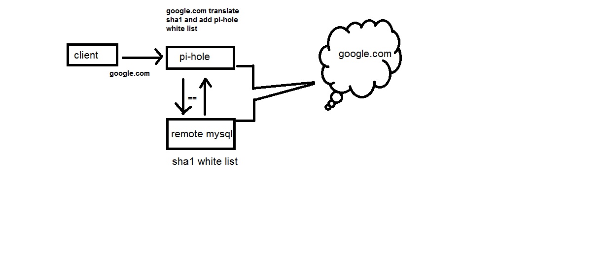

i have a dns server, it receives requests from client and redirects to internet if whitelisted. Now my whitelist is a remote mysql, encrypt it with sha1. my problem is "google.com" should be encrypted with sha1 and compared with whitelist (sha1), if it matches it should reach internet, how can I do that?

I tried to explain in the picture pi-hole is a nice and useful system, if I can succeed it will be great. I have such problem because data in remote mysql is sha1. If I add the lines as sha1 instead of x.x.x.x.com to the pi-hole whitelist, will my work be solved with the help of php?

Thankyou for the diagram. You have two obstacles:
  1. As @Bucking_Horn says, Pi-hole uses domain names and URL lists and does not source lists from databases
  2. Pi-hole uses lists of domain names, but you have lists of SHA1 checksums
If you had some way to interrogate your remote whitelist database and extract the domains into a single list, you could have Pi-hole add those to its own whitelist.
But in your case you would first have to translate the checksums into the original domain names. There is no easy way to do that. If you have a process which turns domain names into the checksums, you could alter that process to store the domain names directly for use with Pi-hole.
Where has this checksum approach come from? Can you replace it completely with Pi-hole and Pi-hole's excellent adlist, whitelist and blacklist capabilities?
