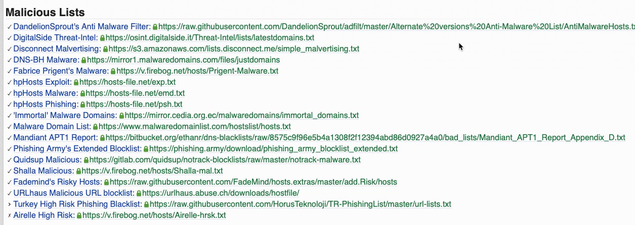

I have added many of the firebog lists and they all work fine.

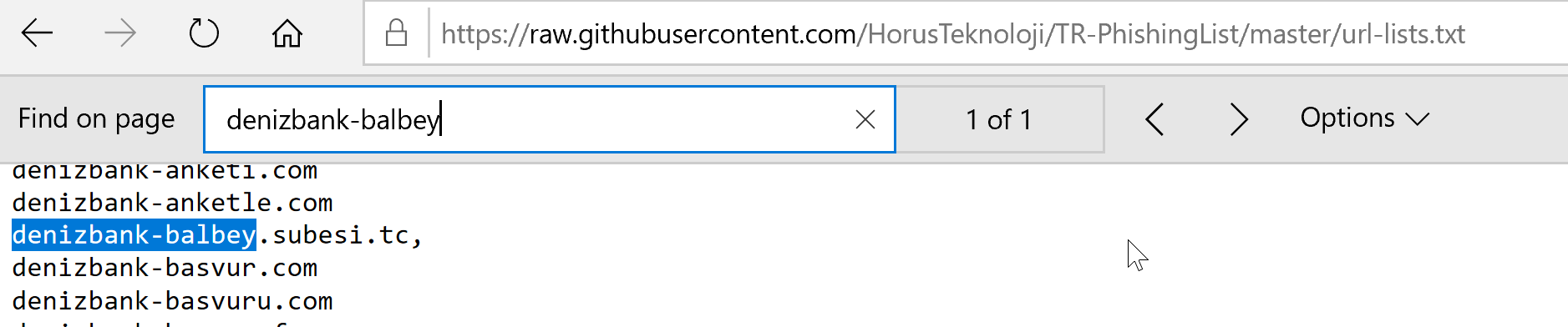

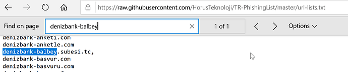

error:
Encountered non-critical SQL warnings. Please check the suitability of the lists you're using!
SQL warnings:
- /tmp/tmp.iJvu6p46n0.gravity:1868666: expected 2 columns but found 3 - extras ignored
Line contains: denizbank-balbey.subesi.tc,,34

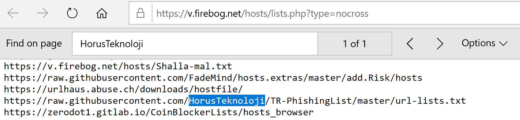

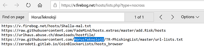

firebog:
raw.githubusercontent.com/HorusTeknoloji/TR-PhishingList/master/url-lists.txt
That's not one of the lists I loaded, but the trailing "," is a problem. I would reject that list entirely. Then, when the list is cleaned up, it will all be imported again.

Send a message to Wally3K, hoping he'll fix it. It is the only error I've got, otherwise, I wouldn't even have noticed the fact that pihole -g now reports these errors, the entire discussion would never have happened...
Wally3K
Why, it's not his list. Try GitHub - HorusTeknoloji/TR-PhishingList: TĂŒrkiye'ye Yönelik Zararlı BaÄlantı EriĆim Engelleme Listesi
