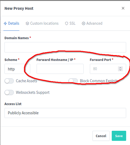

All I know is this for certain. When I install AdGuard Home on my Raspberry Pi device using the dietpi OS, I am able to connect to my AdGuard homes web interface using the Pi device IP address followed by the port number and I can also use the IP with /admin/. With Pihole I am forced to use /admin/ only.
This is not a problem for you, but it is for me. How am I supposed to get Nginx Proxy Manager to redirect my FQDN if it requires a port with the IP and doesn't accept /admin/. I need this so I can use my SSL cert in NPM to apply to the pihole redirect.
I have been asking for help to figure this out for the past 2–3 days and I still don't have a clear answer, nor did it seem like the team member who has been speaking to me has any experience with this. I don't understand, what's so difficult to understand about this?
Very simple. How do I access pihole web interface with a port number behind the IP? If it can't be done then please pass this along to the developers because it very much should be possible and would be great if it was considered for version 6. Self-hosted services should always have the ability to access web interfaces with a port number. Too many users have NPM these days to ignore that.
As it stands right now I can use the 'local DNS records' option but this is HTTP only so I can't use my SSL cert from NPM.
Am I making any sense? I mentioned this in a self-hosting discord and Subreddit, and everyone there understands what I am saying.
See what I mean? I have to use a port number in NPM. It has to be the port to the actual web interface.
