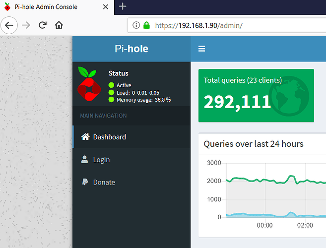

So, what would be the next step? The certificate is working as if I go to the IP it works.........I inspect the certificate in Chrome and it is indeed that certificate with the CN and SAN....

It doesnt make much sense if I go to the IP and it works...right?

If I go to the IP, it presents the certificate correcty and it works. This means it actually loads the certificate and presents itself as safe
