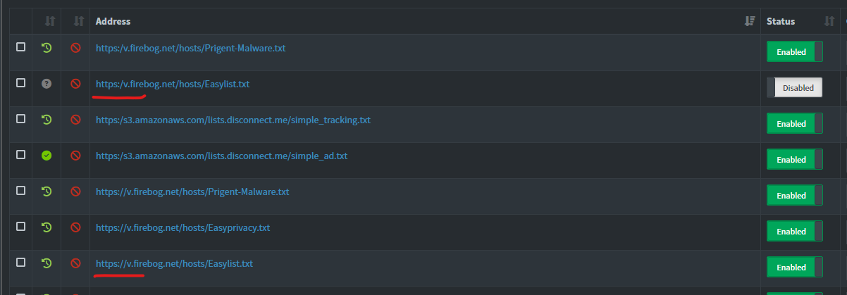

The slash is present on the UI for the original record, so I'm not sure how it's dropped. The original record is the one at the bottom in this image.
I couldn't find a way to insert a list address and lose one slash from the URL. Looks like it was a typo.
Your debug log and the screenshot above show other lists with a missing slash.
They are the 3 most recent entries in your database:
All older entries (including the older https://v.firebog.net/hosts/Easylist.txt) are correctly showing 2 slashes.

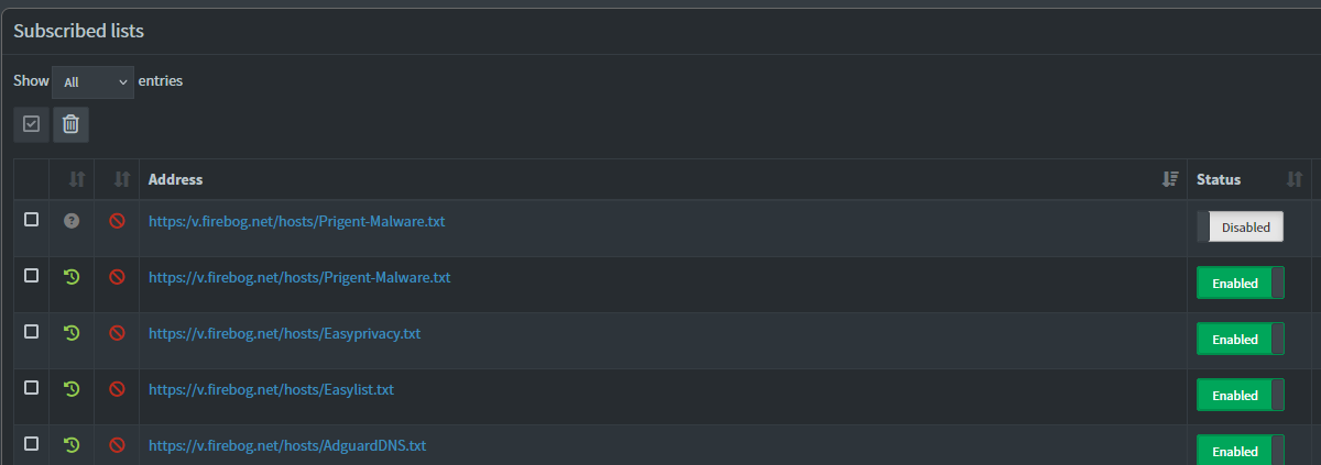

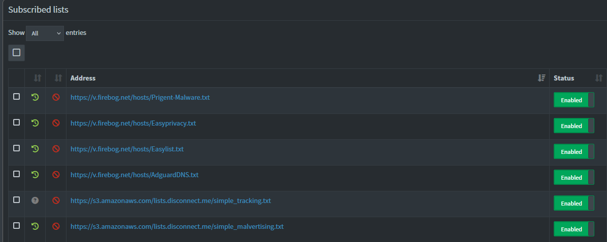

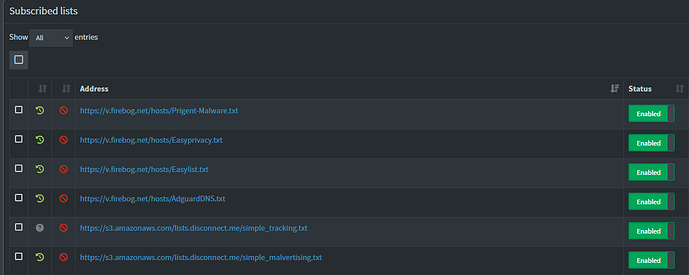

I've fixed the entries with the missing slash (re-added the entries with correctly formatted URLs and removed the single-slash entries). I can confirm that the issue still occurs - attempting to disable a list results in a new disabled list added with one slash dropped from the URL and the original list still enabled.
Before:
After clicking Enabled slider:
