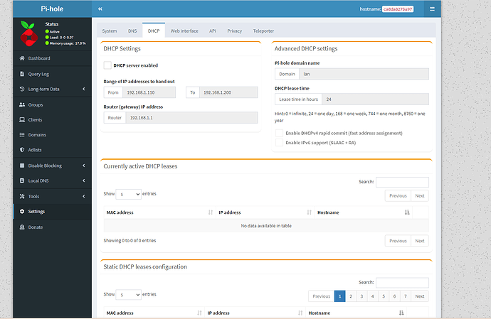

I want to use DHCP LAN-wide within P-Hole so I disable DHCP in Orbi and Enable in Pi-Hole.
Without DHCP server turned on, things appear to be normal (see Image 1 & 2)

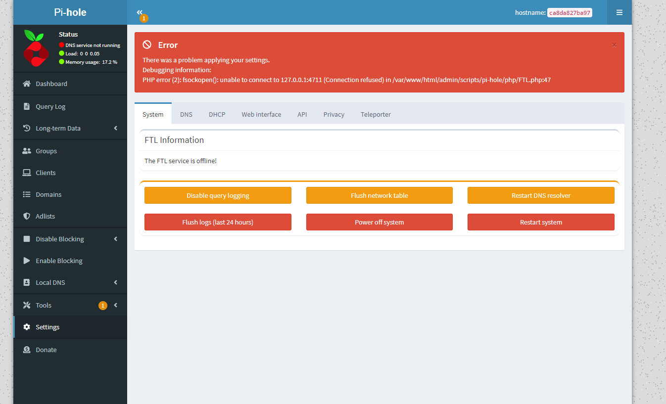

When I enable Pi-Hole DHCP it breaks the dashboard and gives error message under settings "There was a problem applying your setting. Debug Info. PHP error (2): fsockopen(): unable to connect to 127.0.0.1:4711 (Connection refused) in /var/www/html/admin/scripts/pi-hole/php/FTL.php:47 On dashboard all categories have NaN at top and 'wait wheels' spin away.
See images 3, 4 & 5

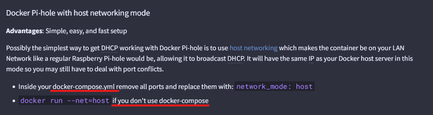

I did not use the command docker run --net=host -- I am thinking I should have.

It is not totally clear how I use the "network_mode: host" command.

The way you implement DHCP broadcasts being heard by the docker container is up to you. The documentation I linked covers that pretty extensively.

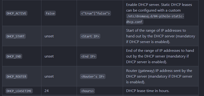

Your docker run command is missing quite a few environment variables that need to be populated if you want to have the container even capable of being the DHCP server.
I highly suggest reading through our well documented README that covers just about anything and everything you'll need to know to run dockerized Pi-hole.

In reading, there was an article that said to bridge outside of the container, you needed to have the
command "network_mode: Host" in the container startup command line to allow it to access resources outside of the container. It said this command would take the place of the -p arguments in the startup command line. Not sure if that article was BS or not.

And yes, if you run the container in host networking mode you will no longer need to specify ports on the command line.
If you are using Pi-hole as DHCP server, you need to add --cap-add=NET_ADMIN to your docker command:
    cap_add:
      - NET_ADMIN # Required if you are using Pi-hole as your DHCP server
