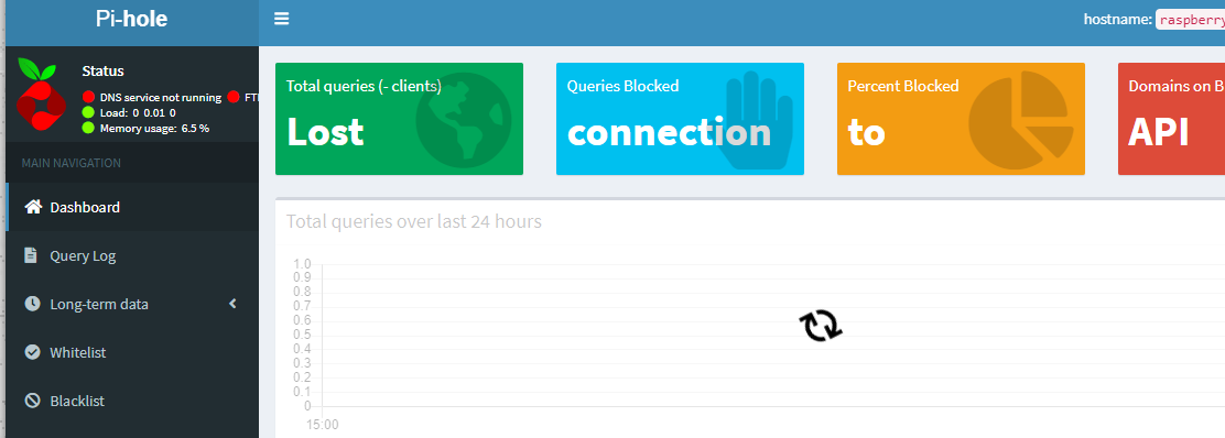

I am enabling the dhcp server within pihole so I can view per device information, I then disable my routers dhcp server. Everything works fine. I can also enter some static dhcp leases into the pihole.
When i reboot, i would expect the system to return to normal operation.. but...
hardware:
pihole installed on: Raspberry Pi 3 Model B Rev 1.2
router is: stock rt-ac68u
The actual behaviour is the system returns looking like the attached image. I then have to undo router settings, and re-enable DHCP on router (so i can make this post!)
I'm just beginning to debug in earnest, but if there is any tips/tricks out there already then I'm all ears!

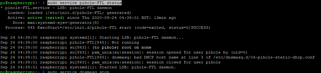

since posting my message and it being approved - i figured it out!
it turns out when i was setting static ip's within the dhcp tab having an underscore as the first character in the name is bad. i removed them and I'm golden
For others who may stumble upon this, i ran:
sudo service pihole-FTL status
which gave me this output:
cracking open the mentioned file, found the line, and noticed the likely culprit.
I was naming them funky like that as my router had lost the naming for some reason so i was copying over the static ips to the pi and labelling them as "_need_to_check_"
