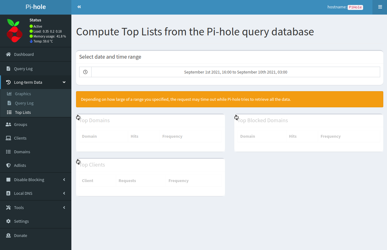

Hi. I recently updated to Raspbian Bullseye on my RPI3, and started over with a fresh Raspbian image. I reinstalled Pi-hole just fine, and Teleporter migrated my settings. But I want my query history retained too. I imaged my SD card before reimaging to Bullseye, and extracted pihole-FTL.db from that backup into the reincarnated Raspberry Pi system. I copied it to /etc/pihole, replacing the empty db that was there, and changed the file ownership to be pihole:pihole. However, in the pi-hole web admin, I can't see my query history. It just isn't there. Is there a step I am missing?
Expected Behavior:
I should be able to see my query history, which is years-long, by going to /admin/queries.php in the Pi-hole admin.
Actual Behavior:
I only see the queries generated by the debugging exercise. My previous query history is not there.

I actually did run those commands before (start) and after (stop) dropping pihole-FTL.db into the /etc/pihole folder, I should have mentioned that. I just ran them again. I still don't see anything other than the queries generated by the debugging exercise in the web admin.
I am still trying to get a handle on my new Mikrotik router, and am aware of the DHCP weirdness. Could have Pi-hole take over DHCP duties once I get this issue sorted.
Edited to correct the path I used and the order of the commands I ran.
If there's another file or another set of files I need to migrate, I can do that since I retained all of the contents of my SD card before I reflashed it. Just need to know what else to do.

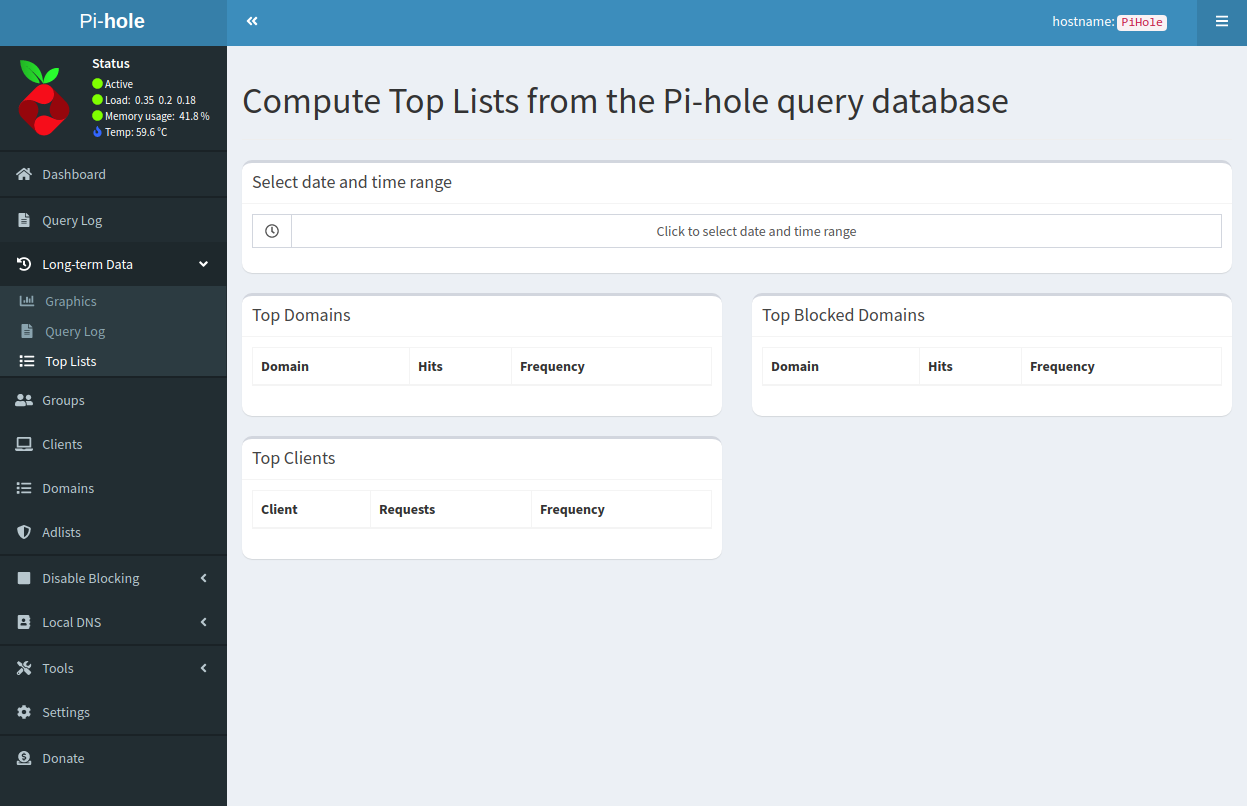

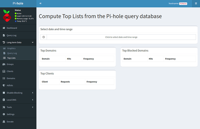

It makes me confident that using Long-term Data | Top lists from Pi-hole's UI with a custom range of September 1st 2021 to September 10th 2021 should produce similar results.
And yet, there's nothing there. Puzzling, isn't it?
You didn't select a date range yet. :wink:
Oops, wrong screenshot. I took one before I opened the date selector and then another one after. Here's a fresh one. It's been like this for a while now...
