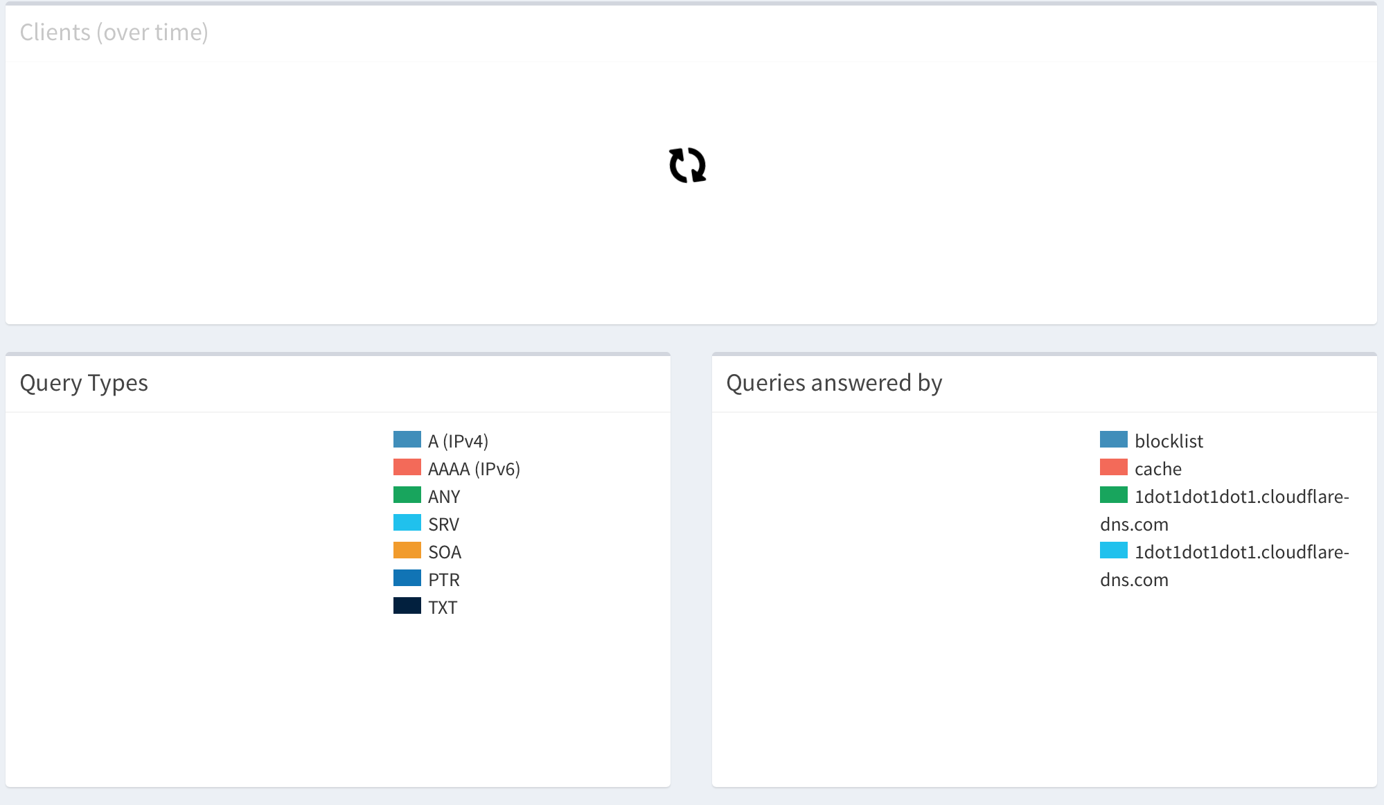

Empty dashboard
statistics should be shown
empty dashboard/spinning wheel
The browser cache I cleared. No differences between Firefox, Chrome, Safari.
pihole -r executed and rebooted, no changes

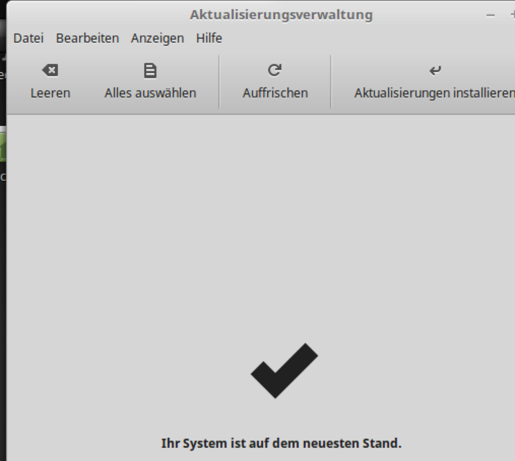

The standard procedures are done regularly and the system is up to date in this way.About an hour ago.
ZBOX ~ # apt-get update && apt-get upgrade
Ign:1 http://ftp.fau.de/mint/packages sylvia InRelease
OK:2 http://archive.canonical.com/ubuntu xenial InRelease
OK:3 http://ftp.fau.de/ubuntu xenial InRelease
Holen:4 http://security.ubuntu.com/ubuntu xenial-security InRelease [107 kB]
OK:5 http://ftp.fau.de/ubuntu xenial-updates InRelease
OK:6 http://ftp.fau.de/ubuntu xenial-backports InRelease
OK:7 http://ftp.fau.de/mint/packages sylvia Release
Es wurden 107 kB in 1 s geholt (105 kB/s).
Paketlisten werden gelesen... Fertig
Abhängigkeitsbaum wird aufgebaut.
Statusinformationen werden eingelesen.... Fertig
Paketaktualisierung (Upgrade) wird berechnet... Fertig
0 aktualisiert, 0 neu installiert, 0 zu entfernen und 0 nicht aktualisiert.

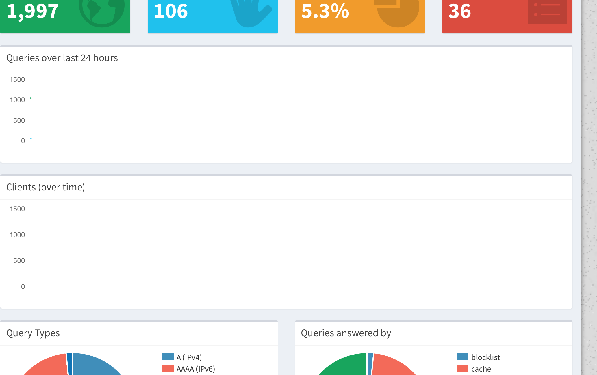

That has no influence/ no effect.
delete the /etc/pihole/pihole-FTL.db file.
The wheel is gone. But the graphs too..
/etc/pihole/pihole-FTL.db is (was) the file with your history.
It's the file that stores the information needed for the graphs to render.
Your data will start to populate after a little use (check it in 60 minutes).
Since it was deleted, there is no information that the graphs can render.
