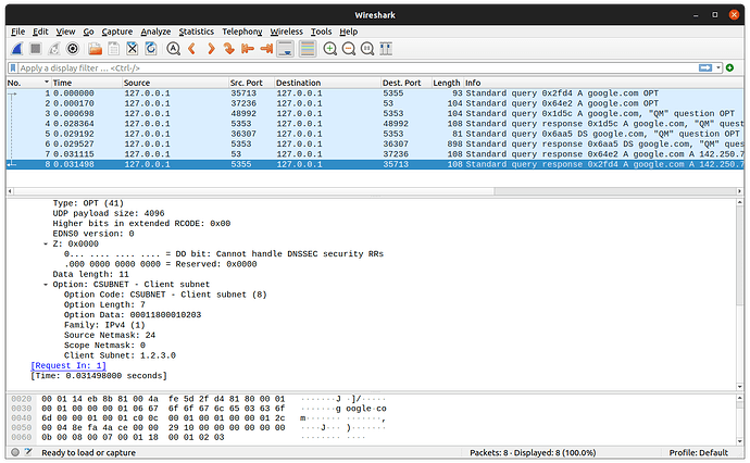

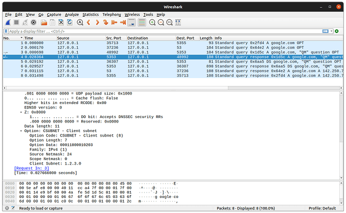

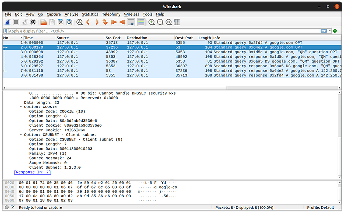

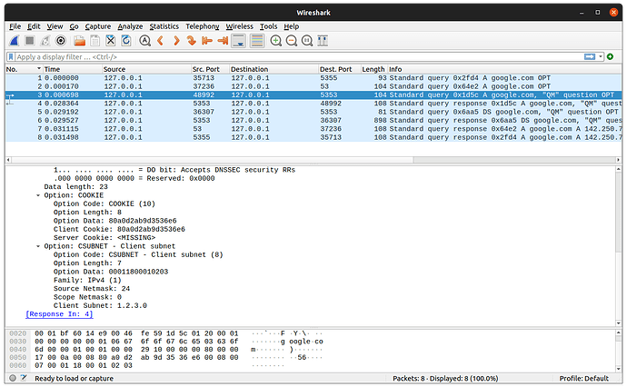

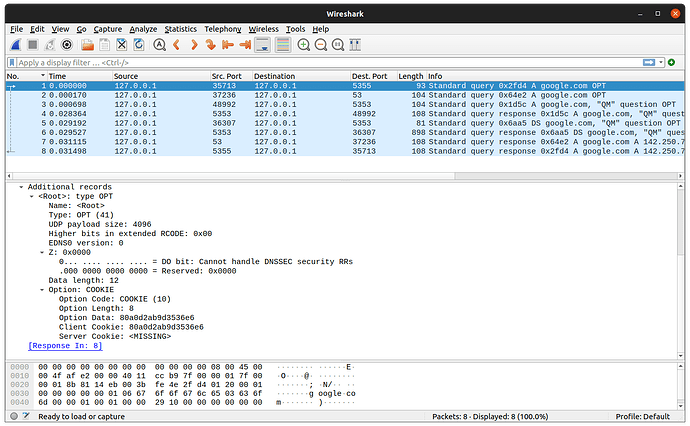

Okay, I tried this now and found two things: (1) FTL incorrectly logs an error because it expected a 32 bit address, however, (2) it still forwards the ECS data correctly.
I repeated my test with a packet dump to confirm this. Let me describe how I tried to reproduce it so you can compare this to your setup:
  1. A client calls dig google.com @127.0.0.0 -p 5355
  2. 127.0.0.1:5355 is a dnsmasq instance is listening with the configuration
    server=127.0.0.1#53
    add-subnet=1.2.3.0/24
  3. 127.0.0.1:53 is my Pi-hole in turn asking 127.0.0.1:5353 as upstream resolver
  4. 127.0.0.1:5353 is a local unbound instance
This tries to replicate your setup albeit everything locally (which shouldn't matter).
The pcaps now looks exactly as expected.
  1. The client asks the dnsmasq instance:

  3. The Pi-hole takes the query and forwards it upstream to unbound (ECS still present):
  4. Unbound replies to Pi-hole (ECS still present):
  5. Pi-hole replies to dnsmasq (ECS still present):
  6. dnsmasq replies to original client (ECS still present):

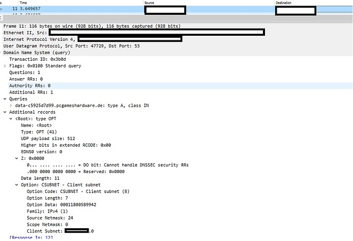

I did another pcap to check if the ECS data gets processed correctly. (why didn't I do it directly :smiley:) The requests getting processed by dnsmasq and forwarded to my upstream resolver, even when I set my network address (.0/24) as edns-client-subnet. That seems to work as expected.
